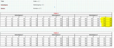

I want to extract a column with data from different tables, where each table contains several subcategorys. See example below (and attached file). Is this possible to do in mathcad?
For example, by selecting "Table 1", "Subcategory 3" and section "C" I want to extract a column containing the right set of data.
Thanks in advance!

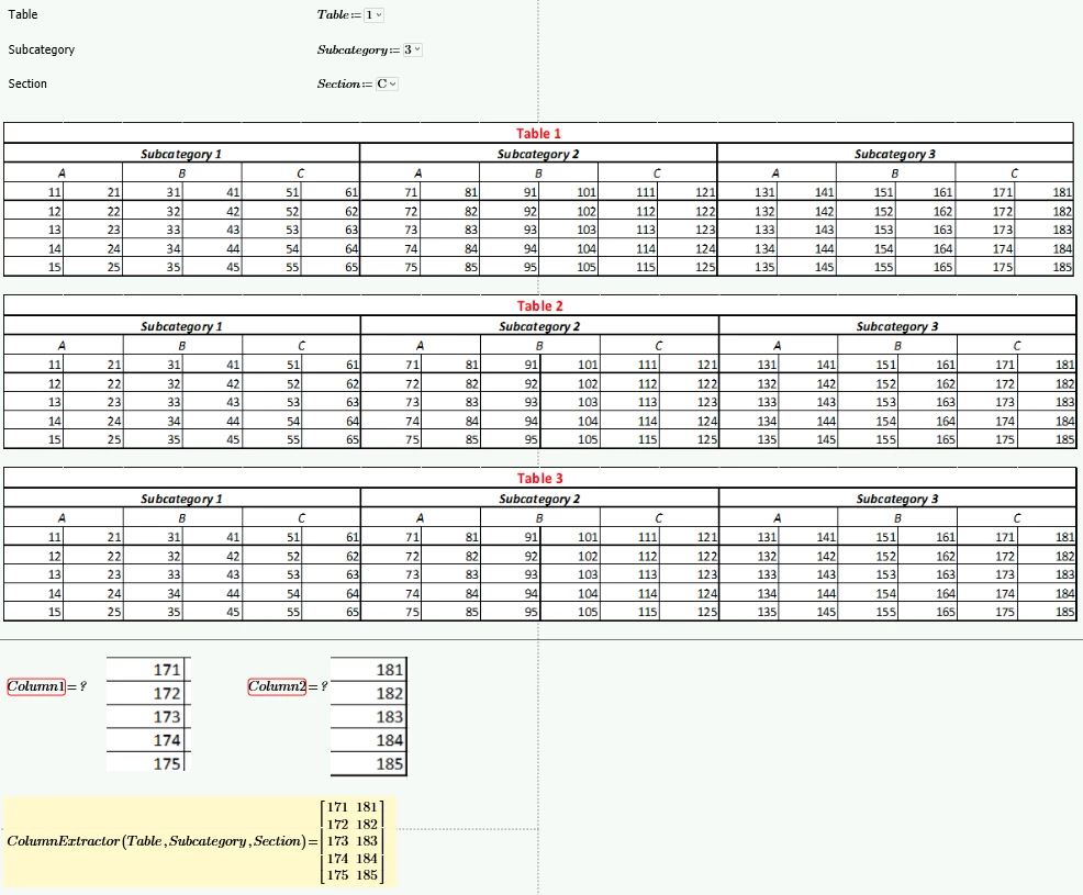

The attached file may help.
Jul 7, 2023 12:31 PM UTC
Jul 7, 2023 1:40 PM UTC
Hello @ksk_10594232 , I've attached a solution that should work for you. There may be several ways to solve the problem, but the method I've provided is straightforward to understand and implement.
