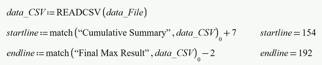

As a workaround and to avoid having to write a parser using the data extracted by READBIN you can detect the correct line numbers via READCSV and the use READFILE as you did.
I replaced the underlines in your data file by spaces and it works OK:
This should work as long as there are no commas in your data file.

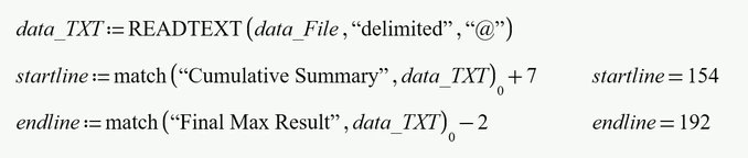

Another option is to use READTEXT with a delimiter character which sure does not occur in the file (I used @)
