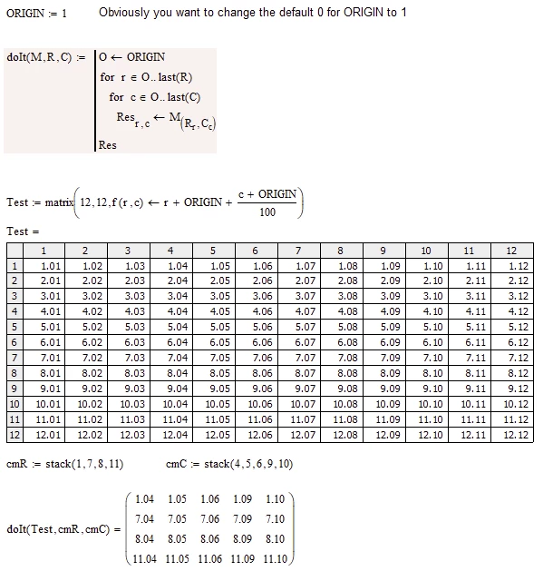

Here is one possible approach:
MC15 sheet attached
Werner_E25-Diamond IAnswer
January 25, 2021
MC15 sheet attached
January 25, 2021
Many thank
It work well after I convert to Prime
