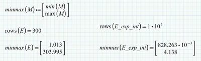

1. For each element of matrix "Em", it is required to match only one closest value from matrix "E_exp_int".
The name of that vector is not E.m but rather simply E.
And E contains 300 values in the range from 1.01 to 304, while E_exp_int contains 100000 values in the range from 0.008  to 4.1.
Are you really sure that you want to look for near values? All values but the first four in E are larger than the largest value in E_exp_int, so theis value (4.138) would be the "nearest" value for them.

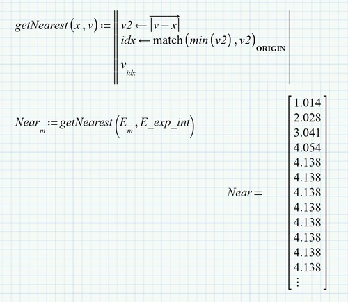

Here is a function to get the nearest value to a value x in a  vector v

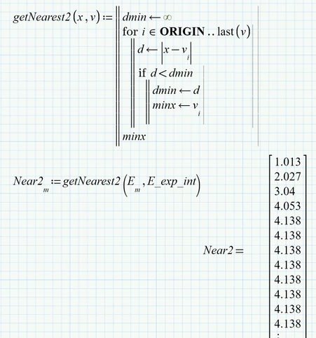

Here is a version of "getNearest" which I would trust more as it does not use "match".

Thanks Werner_E for your effort. I understand your point on setting ORIGIN:=1 and m=1 in the beginning itself, and also about the comparision of E and E_exp_int.
Before posting here, I was aware of the fact that if for m=0, the worksheet does not evaluate completely and also about the fact that  a few values are there in E whose magnitude is close to the several values in E_exp_int. But, I may have some "f" results which in turn can make  E_exp_int featuring several nearby but different values and some exactly same values. At present, I see that we are getting several nearest values just because interpolation is too fine. But it is certainly not desirable to print several duplicate values (as mentioned in my original post we need only one nearest value), e.g, 4.138 occurs several times in Near2. Further, I need help in printing corresponding matrices of "flow_int" and "obstruction_int" . Please help.
