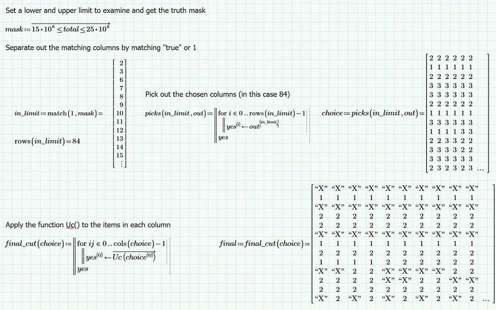

attached file (build by Terry Hendicott) creates a 13xYYY matrice from an 13x3 indata matrice. It calculates the inverted product of each column in the 13xYYY matrice and plots it in the diagram.
Now I would like to extract those columns with a product between two values (Here it is 15 and 25 millions)
Then I would like to present those columns in a new matrice like

Hi
Like this:
terryhendicott
Hi
Like this:
8-Gravel
Beautiful! Thank you!
