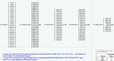

I have attached P10 sheet and an Excel sheet I am reading from. Many thanks to Werner and Stuart for helping me get this far. On page 12 of the Mathcad sheet, you’ll see the results of the axial forces and moments imported from the attached Excel file. On page 13, I’ve listed a couple of questions I need help with:

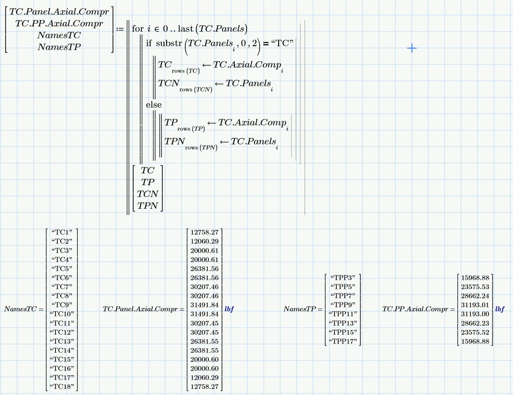

1 How do I extract from the [TC axial Comp] forces of the panel forces (e.g. TC1, TC2, TC3, TC4, .... ) and place them into a vector labeled TC.Panel.Axial.Compr?
2. How can I extract the [TC axial Comp] forces at panel points (TPP#), such as TPP3, TPP5, TPP7, TPP9, … and place them into a vector labeled TC.PP.Axial.Compr?

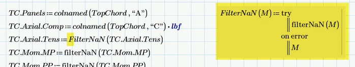

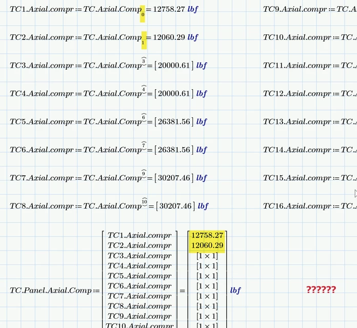

You used the row operator to extract the data and so you created 1x1 matrices. You should use the vector index instead as shown for the first two values in the pic
Page 12:
You get an error when calculating TX.Axial.Tense which results in this variable being undefined. Reason is that "filterNaN" throws an error if the matrix/vector supplied does not contain a single NaN. You may use try..on error.. to trap this case and create your own "FilterNaN" function (I used a capital "F" so not to overwrite the built-in function).
This simple function will erroneously return the unchanged matrix/vector if every rows contains a NaN. To cope with this a more elaborate version could be used

I hope I have understood correctly what you need. Here is a simple way to split the vector, depending on whether the name starts with “TC” or not.
To be on the safe side, I have also created vectors with the corresponding names in case you need that mapping.
I hope this helps.
In case you need this kind of splitting more often you may consider turning it into a utility function.
