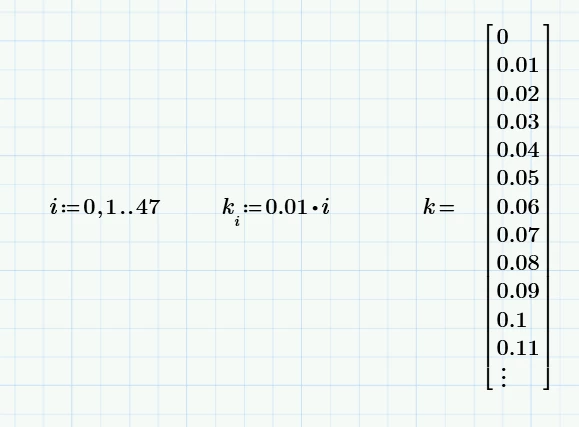

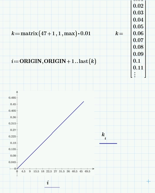

Make sure you have an index into the vector and plot it against that:

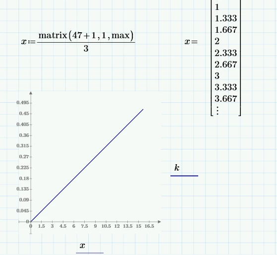

You can also plot two (equal length!) vectors against each other:

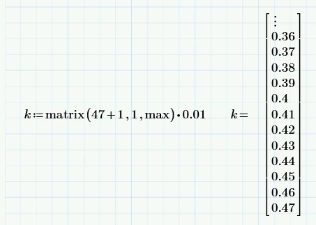

There's a better way:
23-Emerald V

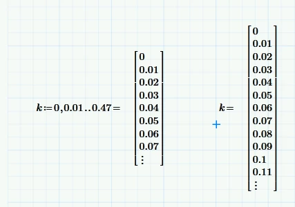

And if you want it simpler, without explicitly defining a range:
Even simpler by using the undocumented trick to turn a range into a vector by using inline evaluation:
