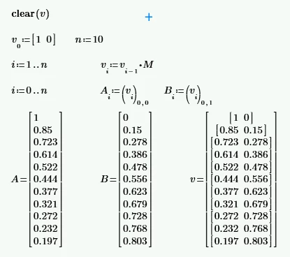

Hi All-
I am attempting to model the first-order change of A --> B. The little programming loop below does the transformation of A to B in time steps of n just fine. The problem is I cannot view the A vs time data as is shown in the MathCAD document below.
I know there are many other ways to solve this simple system, but getting this little programming loop to solve the problem is my goal.

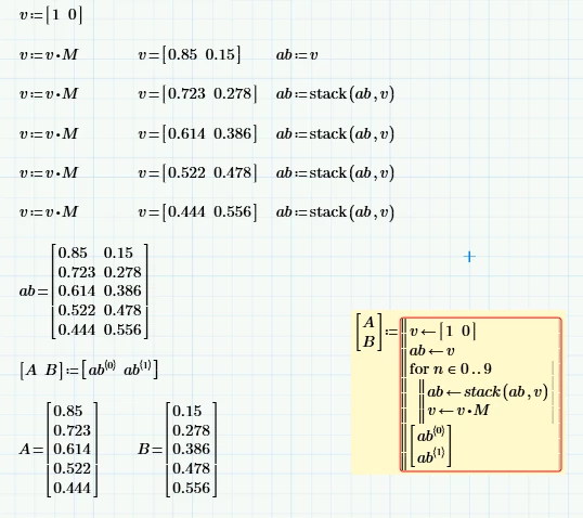

@Caleb01 wrote:
Hi All-
Hi Caleb,
The reason your program isn't giving the expected result is that you are storing arrays. You either need to write a function/program to flatten them or store the values more directly.   In this case, the latter option is the easier option.   Use stack or augment when you want to create flat arrays of values.
I've only got Prime Express, so can't use programming, but I hope the following should help point you in the right direction (the program may even work!).
Cheers,
Stuart

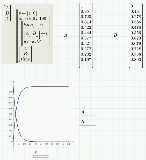

How about this approach?
Caleb013-NewcomerAuthor
3-Newcomer
May 18, 2020
Clean and elegant! This is the result I had envisioned when I first started this little task.  I just didn't quite know how to get there.  Thank you.
