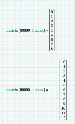

In addition to the above, I've also noticed that Mathcad Prime extends the gap between the evaluation operator and an array when the array is showing the first rows of an array with a large number of rows.
More of a preference thing, but I think it would look better for the gap to be consistent.

Hi Stuart, I think it is done to leave space should you need to see to turn on the show indices feature - the longer the matrix the wider the space for the largest number without everything jumping sideways which might trigger other issues - and as we have experienced with earlier versions layout/page location stability has been a challenge.
