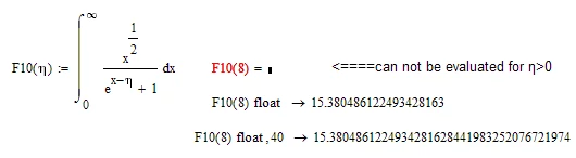

Hello All,

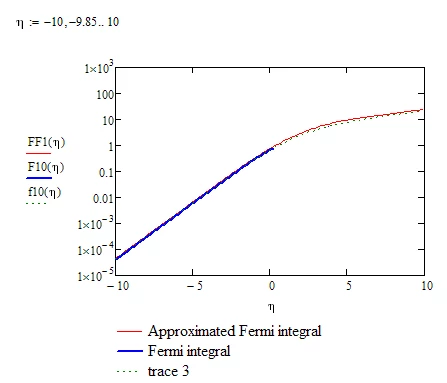

I am trying to calculate the Fermi integral of the order of 1/2 and its derivative. In the attached worksheet, the integral cannot be evaluated for x>0. I used an approximated model as is given in the following article but the result is not similar to what the article obtained.

To get single values you may consider using symbolic evaluation with "float"
For numeric approximation (for plotting) you may also use the same integral with a rather high upper value (not sure in which range this would be an acceptable approximation)

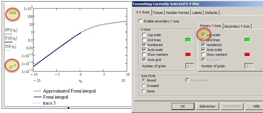

And to make your plot to math the one you try to duplicate you will have to
  • not use the secondary y-axis (otherwise you will have different y scales)
  • set the plot-limits manually
  • notice, that the plot in the article uses a logarithmic y-scale

Just wanted to add, that you don't need to define eta as a vector and create the vectors for FF, etc.. A simple range is all thats neeed and if you are happy with the default range from -10 to 10 of the quickplot feature, you may also omit the range defintion altogether.
