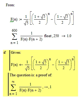

Fibonacci number and a proof of ...?
Hello Everyone.
Thanks in advance for your time and help.

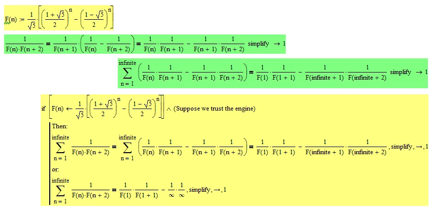

I have been working on separate project, this may shed some light on what you are looking for.  The work was done in Prime 6.
Cheers

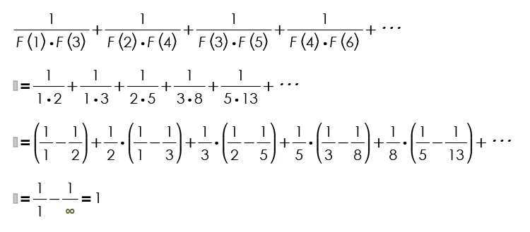

I got it, Ttokoro. I understand your proof as the following:Proof 1.PNGProof 2.PNG
Thanks again for time and help.
