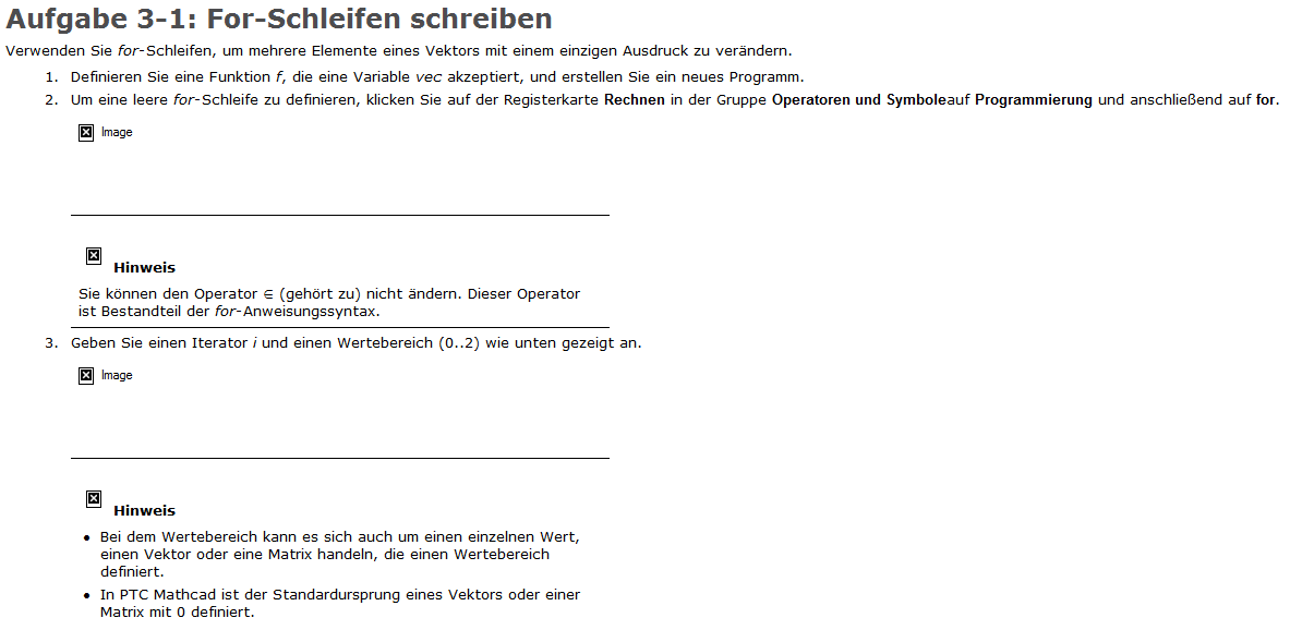

when I look to the learning Programm, I can not see the figures in it. A screenshot is seen below. Can you please help me?

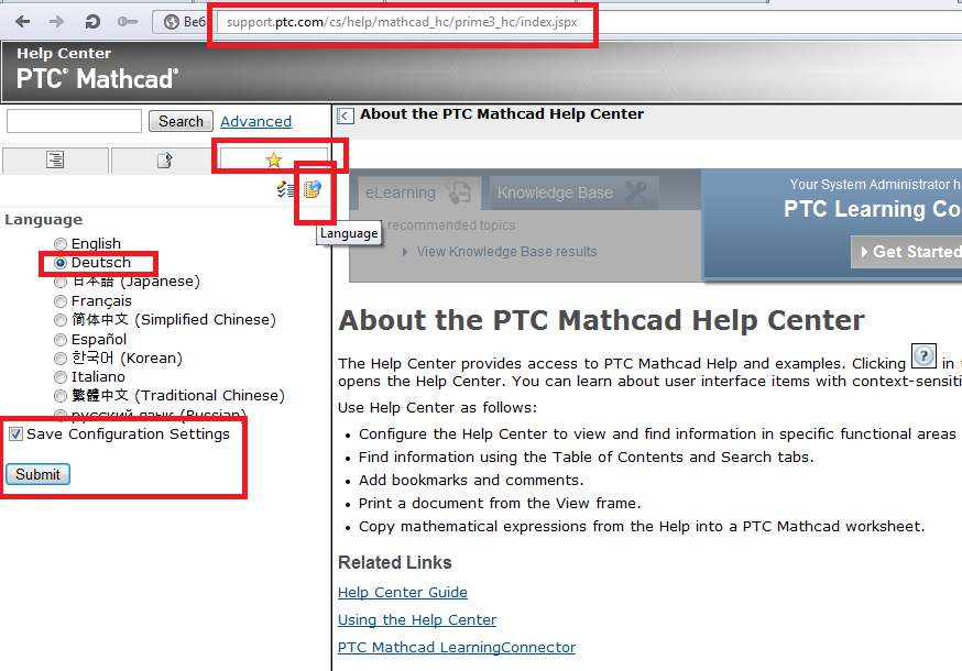

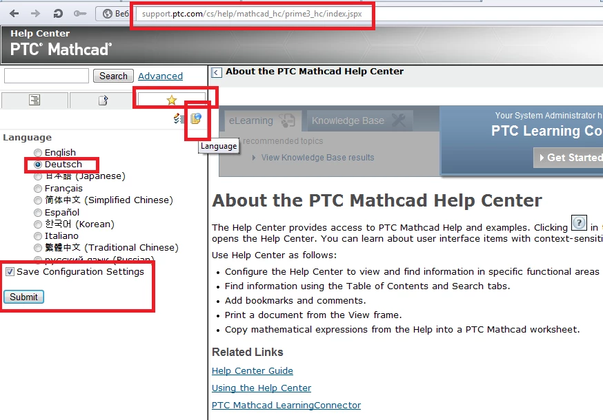

Mathcad Prime 3.1 help center also available online: http://support.ptc.com/cs/help/mathcad_hc/prime3_hc/index.jspx

August 12, 2015
You may be missing a component (although I have no clue what component that could be), or the German version doesn't have the pictures.
Try re-installing?

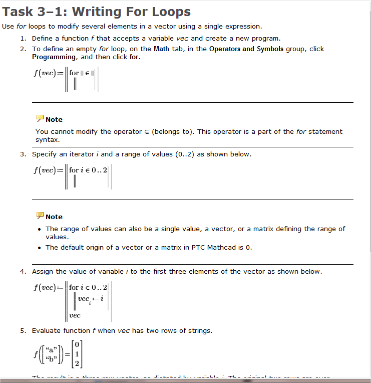

Below picture is from Prime 3.1 Express edition.

August 14, 2015
Just note that to change the language, you must go to on the tab "Configuration" ---> "Language":
