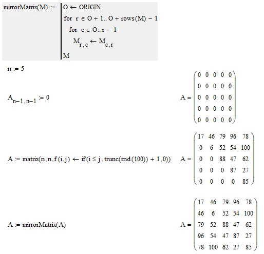

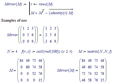

I'm building a matrix where the off-diagonals are equal (e.g. M(1,3) = M(3,1) etc.).   Is there a way to reference the M(1,3) to populate the M(3,1) element?
That way I would just need to populate the diagonal and upper triangle and below the diagonal would be completed.

A tiny user-defined function may do the job:
