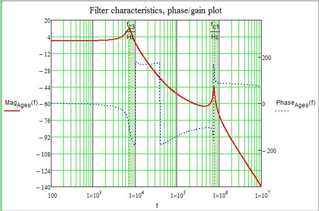

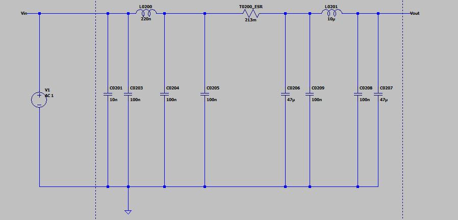

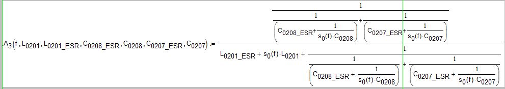

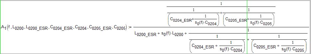

i want to calculate following filter in series:
LC+RC+LC

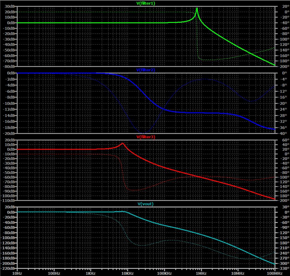

spice simulation result:
with following transfer functions:
filter1:
filter2:
filter3:
Could i multiply all three transfer functions in laplace?
As result i get a different magnitude like in spice simulation. Could it be that transfer function of all in series shall calculate in a different way?

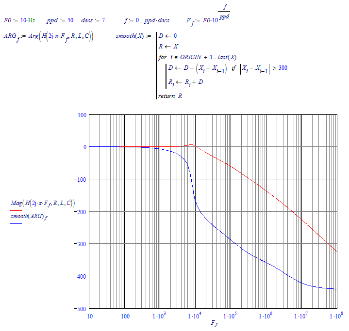

Second Question: How can i display the phase without overdue of 180° in the diagram?
Thanks in advance.
Michel
November 10, 2016
Hi Michel,
You can't simply multiply  the three transfer functions. Doing so, you obtain a transfer function that isn't the one corresponding to three cascaded filters
Insted to obtain a transfer function that is the one corresponding to three cascade filters, you must place a buffer between each filter.
In other words, see the bloch diagram:
Results for R=21.3mOhm
Results assuming R=213m_Ohm:
November 10, 2016
A few initial points:
  • the caps directly across the voltage source do nothing for the filter , they simply present an additional load on the voltage source so you can remove them for the analysis of the filter
  • to simplify things you should consider the parallel caps as single components
I would normally use a nodal analysis and solve for the various circuit currents using matrices (which is what Mathcad is good at).  Here is a useful link to this technique: https://en.wikiversity.org/wiki/Electric_Circuit_Analysis/Mesh_Analysis

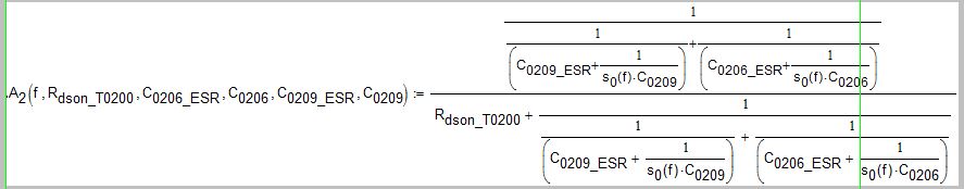

November 12, 2016
Assuming that the T0200 device shown in your first circuit diagram is a 213 mOhm resistor (you indicate that the middle part of the filter is an RC section), the graphs you provide of the simulation do not match with the behaviour of the circuit. The phase characteristic you have is showing an increase in phase shift from about 12 kHz to 120 kHz. With the circuit as shown the phase only decreases.

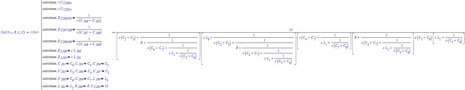

In Mathcad the circuit can be analyzed with:
Then:
And we can set:
Which gives:
From which the transfer characteristic is found with:
giving:
Now we can plot:
