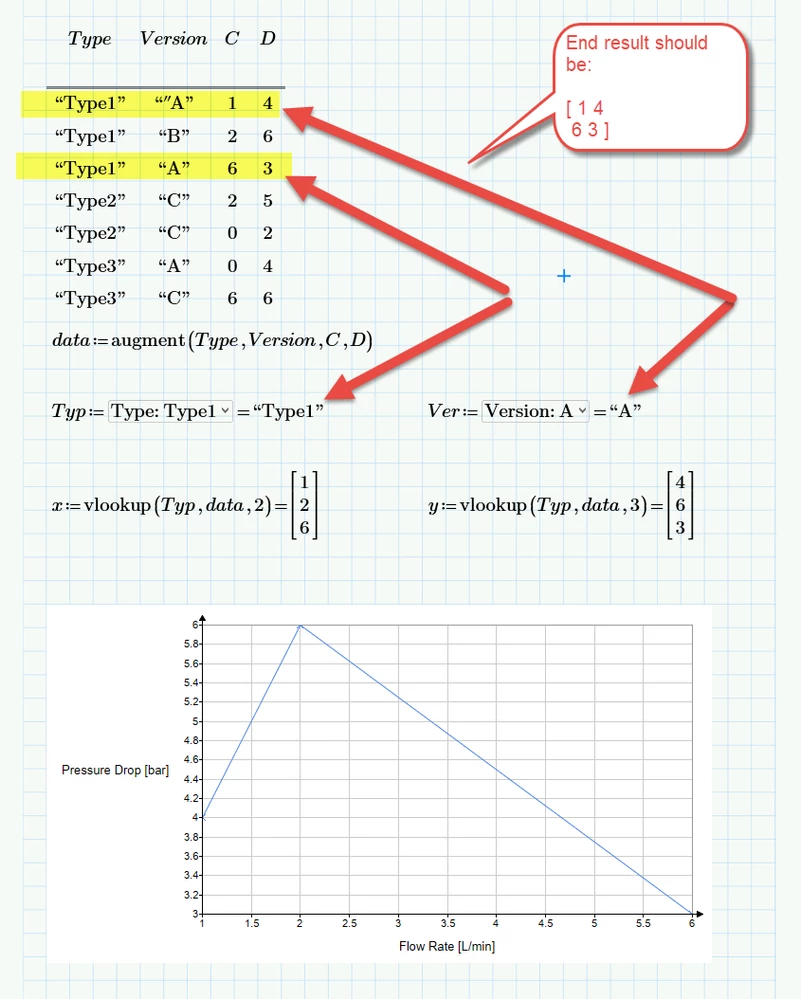

Is there a way to make a filter based on comboboxes ? i.e.
I want to be able to filter "Type" and "Version" so that the end result is a matrix i can plot
I used vlookup to easily filter "Type", but not sure how i can incoorporate the "Version" filter?
(I've attached my sheet, MCP 9)
Thank you!
Regards
SNA

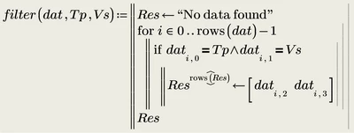

It looks to me that you are looking for a n x2 matrix as the result of the filtering!?
You may write a filter function like the one shown below
BTW, you had a typo in the version "A" in the first data row, there was an extra "
Werner_E25-Diamond IAnswer

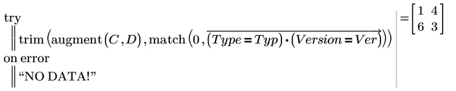

Here is a different approach, a tricky one-liner
You may use try  & catch for some error trapping

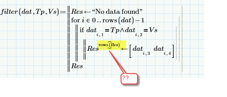

Hi @Werner_E
Thank you so much!
Your first suggestion worked perfectly on a bigger data set i have 😁 Although i must confess i do not quite understand what is happening here:
I will also try your one-liner 🙂
