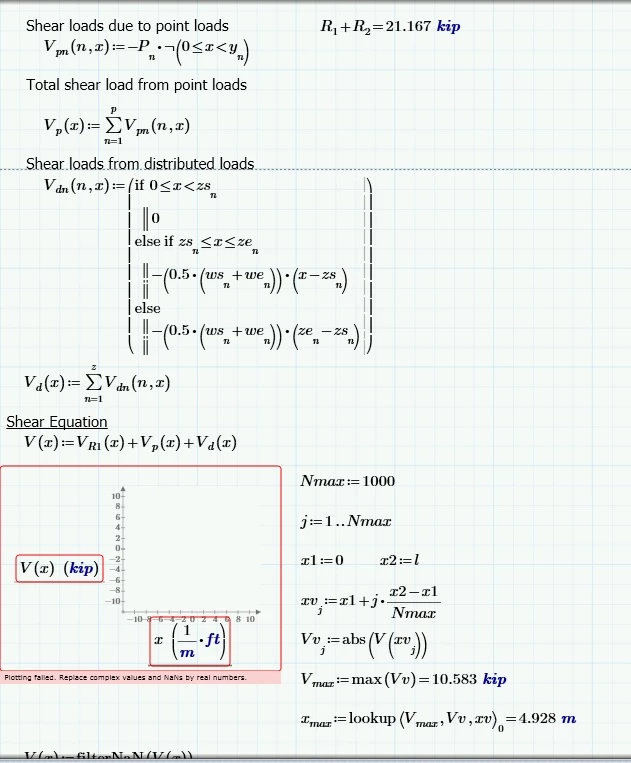

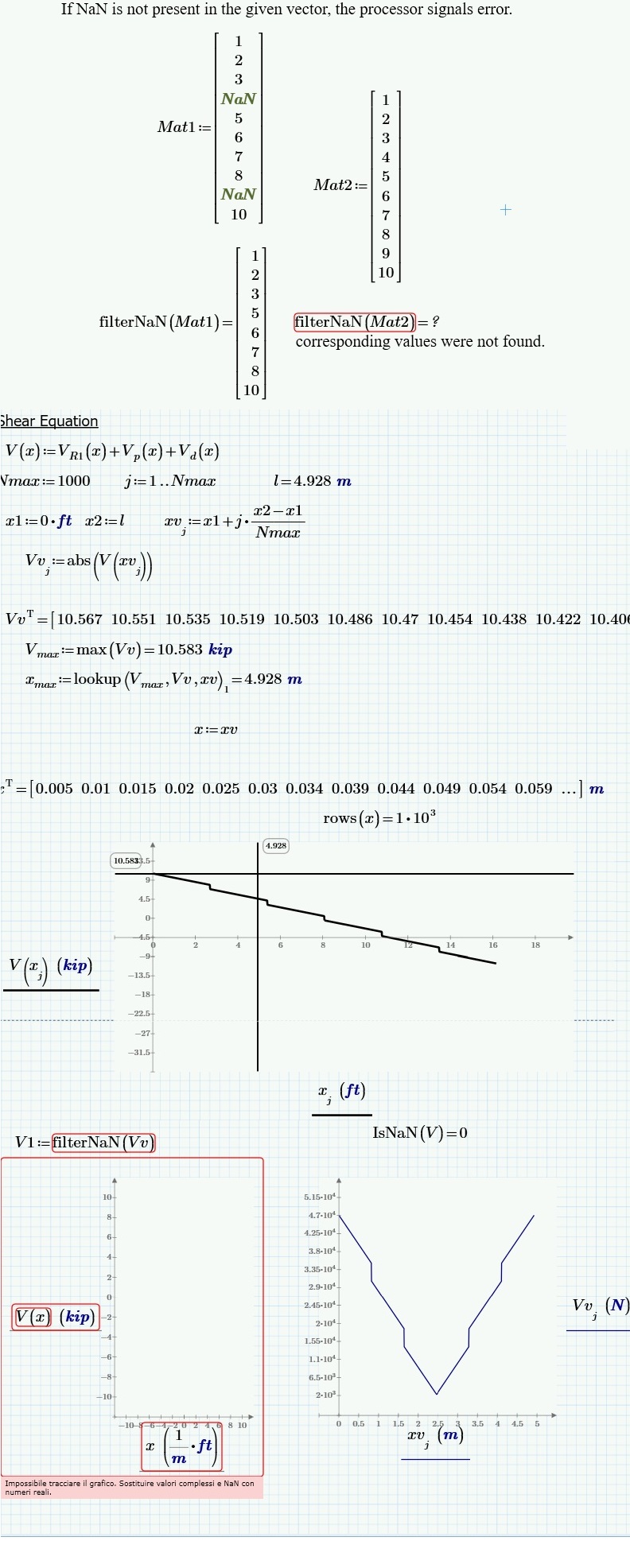

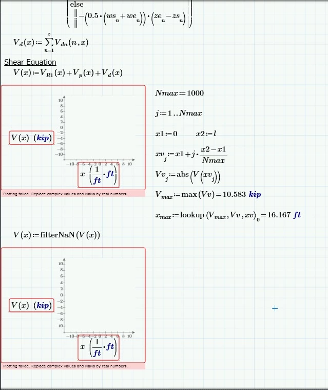

In the attached worksheet there is a plot error (Plotting failed. Replace complex values and NaN by real numbers.) I've tried using failterNaN to remove the NaNs. Is there a way to remove the complex results?

In Filter 1 you define ORIGIN:=0 (that's default any way.)
In Filter 2 you have
so the first element of xv is not defined, 0 by default, but no units.
I don't see where you define x, but:
suggests that x has no units--you put in feet and Mathcad divided by meters to balance the units.
I think that's your basic problem.

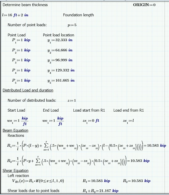

Fred,
Please find PDF document of this worksheet in attachment.

filterNaN does not work the way you use it and would not help anyway.
A 2D plot will only fail with that error if ALL values are NaN or invalid and I suspect that the latter is the case.
I can't read P3.1 and I could not be bothered to switch between three JPGs to debug.
But I would suggest you try to evaluate your function V for a simple single value.
What happens if you type V(2 ft)= ? Where does the error trace to?

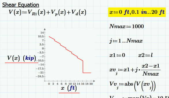

EDIT: Fred could possible be right (again). Try to define a range variable for x, like x:=1ft, 1ft+1in .. 10 ft or whatever seems appropriate.
Just remote connected to a machine with P31 and can confirm, that Fred is right.

Thank you all very much, the issue was that x was not defined.
