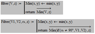

Helo folks!
Please see the attached file.
How can I filter the range variable or vector so that it basicly creates a new one but for values greater then, let say 9 (like in the file attached) it returns 9 for all remaining values in the range.
Please help.
Thank you.
Jun 18, 2014 8:01 AM UTC
Something like the attached?

Jun 18, 2014 8:15 AM UTC
Perfect! 🙂
So the number in the brackets controls the limiting value and in the same time it names the new vector?
Jun 18, 2014 8:17 AM UTC
Second and improved version.
I have used the match function to find the indices in v which are greater than z.

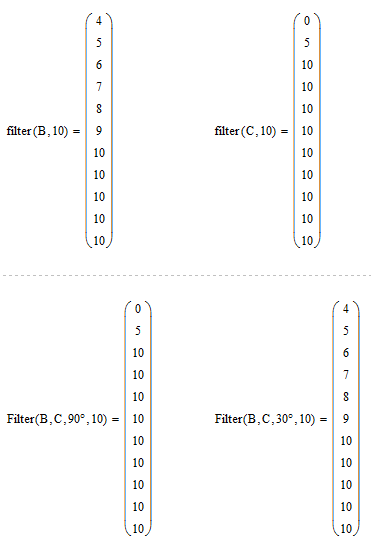

Jun 19, 2014 1:11 AM UTC
Here is a different approach. I would prefer making the vector(s) to be filtered and also the angle arguments of the filter function:
Jun 19, 2014 5:42 AM UTC
Very nice Werner
So basically you have defined Min(x,y) as a function which allows each element of V to be looped through using Vectorize? I totoally forgot about this feature.
