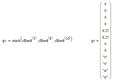

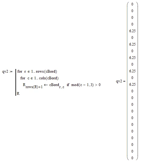

Or do you have something like this in mind?
"Some data columns"???
Which columns?
The vector qv you define does NOT consist of some data columns of the matrix cBoard!
You can create a vector built from data columns of the matrix cBord using the "stack" command and the column selector
Werner_E25-Diamond IAnswer
