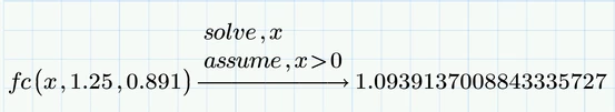

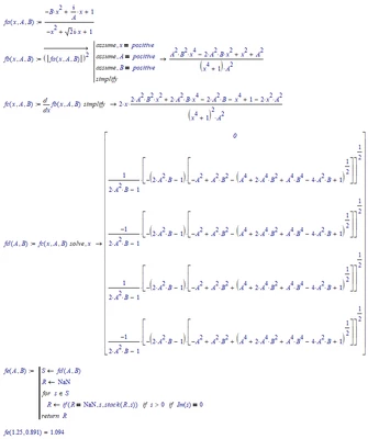

Please see attached worksheet (I'm using Prime 3.0).
I would like "fd()" to return only positive real results.
Is my problem perhaps that in function "fd()" that it cannot know whether or not the solved variable (x in this case) is real, imaginary or negative etc.?  And if this is the case is there a more appropriate or accepted way to filter out the unwanted results?
Thank you.

How about this:

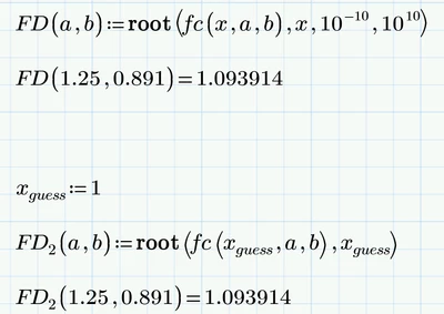

You may also consider using a numeric solver. Either a solve block or the "root" command in one of its two flavors (providing a range or providing a guess)

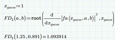

Maybe even without fb and fc using numerical derivative

I think the thing I am taking away from this is: when a solve statement is used inside a generalised function, the set of solutions is necessarily also generalised and assumptions about certain variables will only go so far to minimise that set.  In reality, to boil down further you have to run the solve with the actual values - does this make sense?  In other words, when using a solve staement in a function, the solution is determined only once when the function is defined and not each time it is called.
23-Emerald V
"In other words, when using a solve statement in a function, the solution is determined only once when the function is defined and not each time it is called."
I guess so.
If you insist on using the symbolic solve, you could do:
Notice that I had to filter out the complex values first, before comparing with 0.
