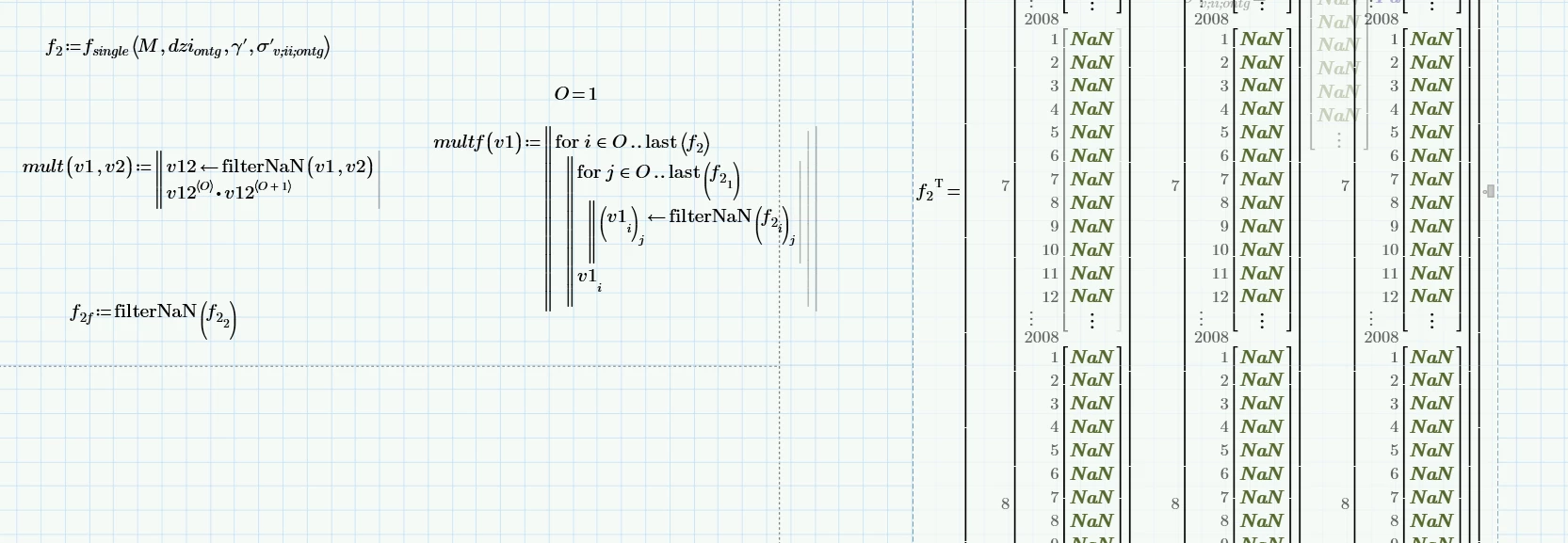

Hi There ,
I want to use this function ( filterNAN) , but I’m not sure how it works . I have a nested array f2 . I tried three different approaches but non is working , in f2 I’m using M and sigma they also have NaN in their values , but not all the values are NaN.

Finally there's filterNaN(x), that filters out all rows of x that contain a NaN. So with no NaNs it gives:
But on the modified matrix that contains NaNs it gives:
just the last row of MN, as the first two rows each contain a NaN.
Now note that for an item to be a NaN, it must be a scalar (single value).
Tells you that the vector [1 NaN] is NOT a NaN (because it is not a scalar)
And so:
filterNaN returns the full vector (of vectors) because it contains no NaN scalars
but
Has filterNaN working with only the first element of the nested vector, that element is a vector and contains a NaN in the second row. Hence it returns a vector with just the first element of it.
