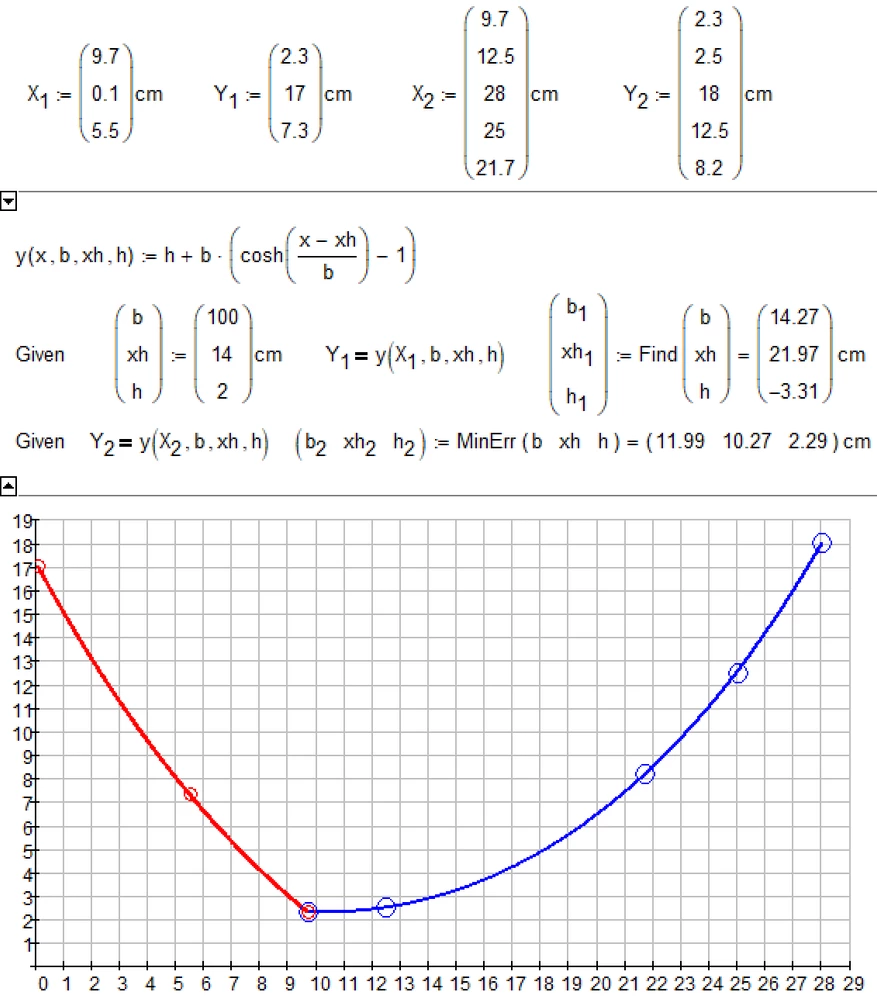

We can use (only in Mathcad 15 not in Prime) a vector or a matrix with one row as an argument of the Find (MinErr, Minimize and Maximize) function.
One example
6 replies
The problem
PS
I have called Find and MinError functions as a prefix operator!
