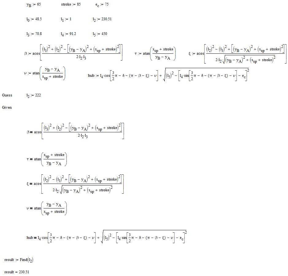

I have here a set of equations in which I try to solve for a variable. First I used a vector to define distance l0 through l5, but Mathcad complaint that it can't accept units therefore I changed from vector elements to single variables with literal subscripts for l0 to l5.
However, now the error says it is undefined. Can anybody tell me the source of the problem?

You haven't defined the variables on the left hand side of your conditions ....
