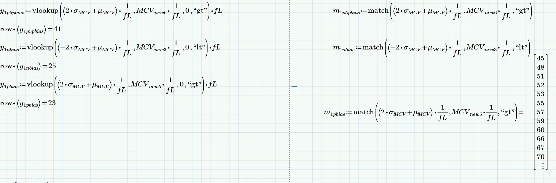

Sorry for not being clear.
I am attaching an image. m1pbias is a column vector and I want to find out only the consecutive numbers. for eg. 51 52 53 is one set. So is 59 60. There are others as well. I want to write a program to find them. Hope it helps.
I am using prime 4.0.

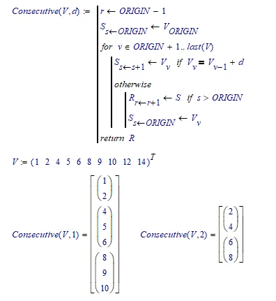

How about:
Note that you can set the difference that you need between 'consecutive' elements with the parameter d.
You should be able to translate this to Prime.
