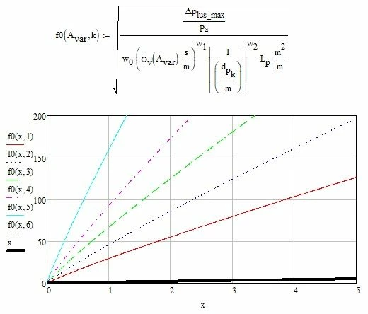

I've learned a lot from other people's faults from this forum in the past, but now I can't fix my problem on my own so I'm asking a question myself this time.

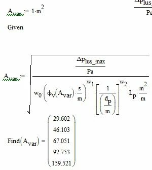

Its about the Find function, which has worked for me before, but not in this instance. Now I think it has something to do with the complexity of the equation I'm trying to solve but I'm not sure.
Maybe somebody can have a look at my file and tell me what I'm doing wrong.
Its about the A.var value which I cannot solve.
Cheers,
-MFra-
Unfortunately it seems to me that the problem has no solution other than the trivial one. See chart: (x=A.var):

Wow thanks for the quick and helpfull response! Also for the attachment, didn't expect that. Its usefull.

Je verheft Phi.v(A.var) tot de macht w.2. Dat mag alleen als die Phi.v dimensieloos is.
Kennelijk is s/m^3 niet de juiste verevening.
Het helpt soms om de expressie even buiten de Given/Find te trekken en te evalueren om te zien of alles 'werkt'.

Hoi Luc,
Ja dat klopt. Het zat hem in de verevening (meters). Dankje voor de tip!
