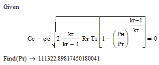

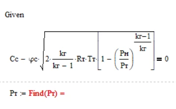

Hello PTC fam, it seems the Find function doesn't work at my end. Mind to take a look? I attached my file
VladimirNAnswer
May 16, 2022 7:25 AM UTC
Before "Given" you need to specify the initial value for the variable you want to find.

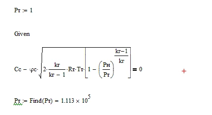

Adlil1-VisitorAuthor
May 16, 2022 12:31 PM UTC
Thank you for the explanation. I did what you recommend and solved it. Thanks.

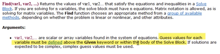

if you evaluate a solve block using numeric evaluation (the "normal" =  ) you are forcing Mathcad to use numerical algorithms which require an initial guess value for the variable you are looking for, as VladimirN had shown.

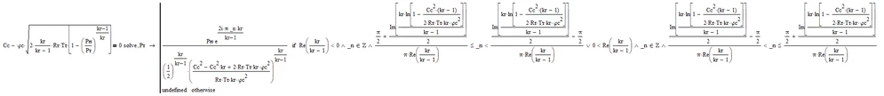

If you evalute the solve block symbolically, no guess value is required:
But  I think that In your case a numerical evaluation is more appropriate anyway.

Why not solve it symbolically, to get an exact answer:
