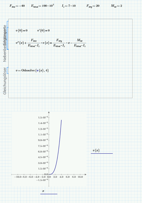

I am pretty new to Mathcad and hope somebody can help me. I need to know the forces and torques acting on a flat spring I have in my machine. In order to do so I have to solve the 2nd order differential equation and put in the boundary conditions shown below. FMy and MM are not known.
In order to solve the equation with odesolve() I have to give values for all constants and it can only solve the problem for two boundary conditions. This is not helpful since I don't know FMy and MM.
What would be a smart approach to solve this problem?
Regards, Daniel

May 23, 2017
First of all, you have to use Odesolve in a solve block.
Then we need initial conditions for solving the differentiel equation.
And we need the constants Fmy and Mmy.
What do you intend to calculate- i think it's a beam bending problem.
The values for E and I are looking strange.
you can work with units in a solve block
see attached sheet.
regards, Volker
May 23, 2017
Thanks for the prompt response. See the worksheet attached. You are correct, we are talking about a bending problem. The units are not the issue.
You say Volker that we need Fmy and Mm. But those are exactly the variables I have to find with my boundary conditions. Once I know them I can calculate the stress in the spring which is what I really need at the end.
In the attached worksheet you can see that I searched for Fmy and Mm by hand. That is quite troublesome. There must be a better way.
BR, Daniel

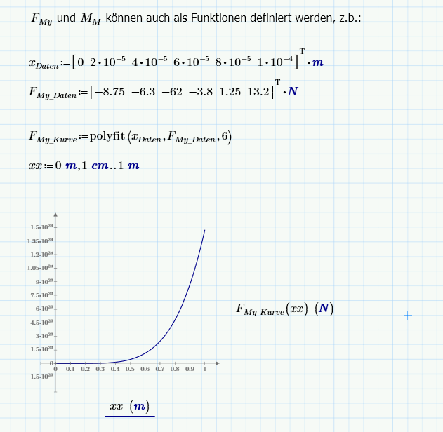

May 23, 2017
Daniel,
maybe it helps you, if we create a function for eg. Fmy- see attachement please.
i assume, that you made some measurements to get data for Fmy.
These data you can apply with the function "polyfit" i created in your worksheet to get Fmy in dependence to x for example, Fmy------>f(x).
viel Glück damit, Gruß Volker
