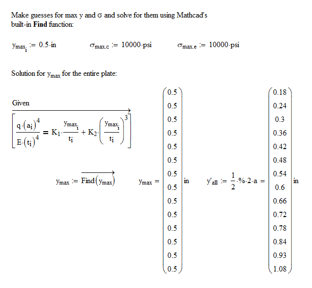

I have two arrays I want to use with a find function. I'm having difficulty getting it to work. Any easy advice? See the clip of the spreadsheet below. The arrays are "t" for plate thickness and "a" for the plate radius. As you can see the definition is just passing through the find function. This is a Roarks workbook copied and pasted into a spreadsheet - Table 24A case 3. Thanks for any assistance. This is M'cad 15.

You need to make the solve block a function of the variables you wish to change.
YMAX(a,t):=Find(ymax).
Then call the function YMAX for whatever values of a and t you wish.
If that information is not enough for you to get it working (which is quite likely!), could you please post a worksheet.

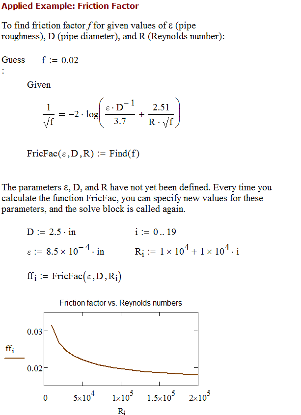

Please see the attached file for consideration. Note I have been "fiddling" with this for quite some time now. I have been attempting to directly followed a "Help" quicksheet and still no solution. My solution looks to follow the example too. See the example below. Thanks again for the assistance.
May 19, 2015 10:47 PM UTC
Get rid of the subscripts in the solve block. The variables are aa and tt. That's all you need to define the function. Different values are passed to the function after you have defined it, not when you define it.
