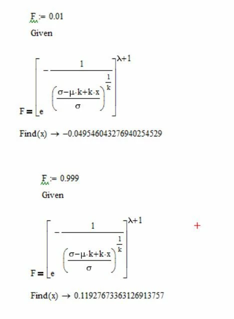

Hello there,
I have a problem to get multiple answers from this equation,
 kindly refer attached file for the problem. thanks in advanced

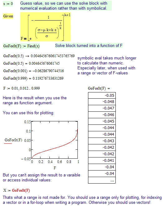

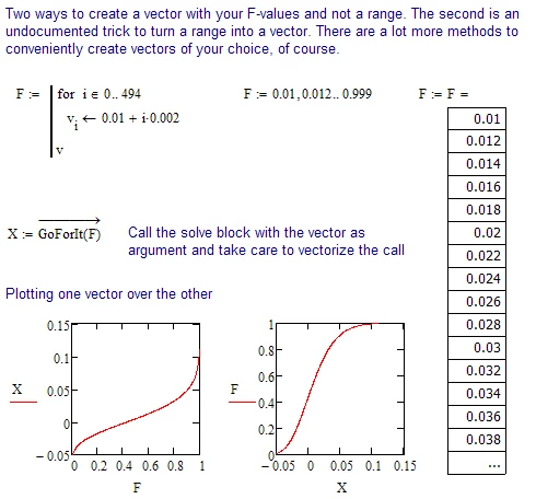

Werner_EAnswer
July 27, 2017
The attached sheet should help!
Be aware of the differences between ranges and vectors!

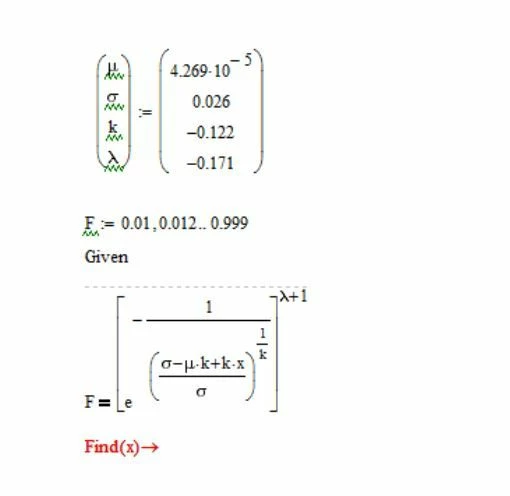

fmarsani1-VisitorAuthor
July 27, 2017

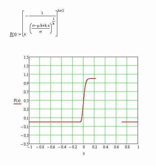

July 27, 2017
There are a lot of solutions (about 490).
What do you intend to do?
with 0.214<x<0.704 we have complex F.
