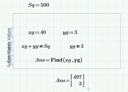

I am working with Mathcad Prime 3.1, and I use the solve block.
The problem is with the function find:  I want to specify directly (like in Mathcad 15 with the index) the element that should be reported. I don't want to report all the matrix and I don't want neither to use an extra variable to report the specified element of the resultant matrix.
Thanks for your support,
Best regards,
Nadia

I am referring to this:
The index is used directly in Find function in Mathcad 15. It is not the case in Prime 3.1.
In other terms, I want to do it in the same way than Mathcad 15.

It's not clear to me what you want. You are finding two unknowns, so the result is a vector with two rows. If you want to display only one of them, just use a vector subscript.

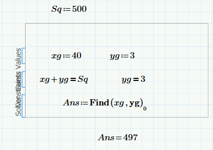

This works in Prime 3.0:
As Fred has shown ist IS working the same way as in Mathcad 15 - at least in Prime 3.
So why do you think that it does not work that way?
You have neither provided a worksheet nor a screenshot of Prime failing using the very same syntax.
The screnshot you provided in your initial post is missing the matrix index 1 and so you get a vector with both values - all as it should be.
Could it be that you failed because you used the wrong type of subscript (literal instead of matrix)?
