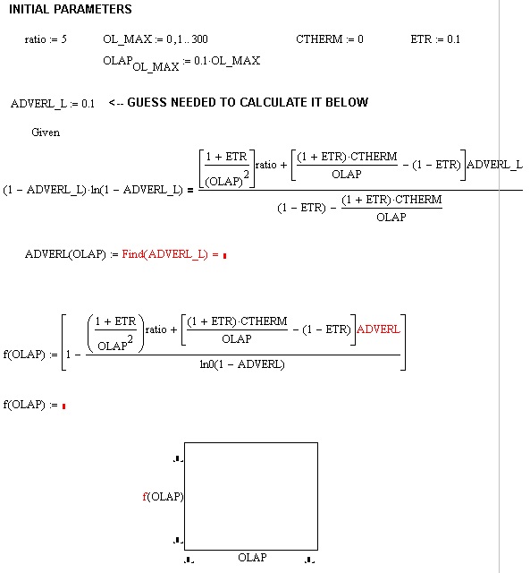

I'm working in a program to plot a curve of the equation below:
I need to have the ADVERL_L found for all different OLAP's, in order to use it below to calculate f(OLAP) and plot it.
I don't know how to use the FIND command to return a vector of answer.
Could someone help me?
Thank you.

Include OLAP as an argument to ADVERL in the function, f, and avoid a divide by zero error by only using non-zero vaslues of OLAP - see attached.
Alan

Now, how do I see the ADVERL answers? Look what I got.
Thank you.

Just pass OLAP[j (that is OLAP subscript j) to ADVERL somewhere below the place where j is defined.
Alan
