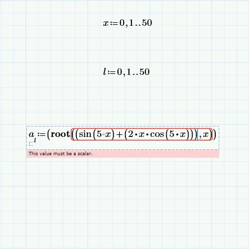

I need to find roots of a periodic equation by making initial guesses of x and assign the derived roots in "a". But, Mathcad is saying " the value must be a scalar". What does "scalar" in this case and how can I solve this?  I also need to sort "a" after assigning.
Thank you very much,
Faisal

Its always better to post the worksheet itself rather than just a picture.

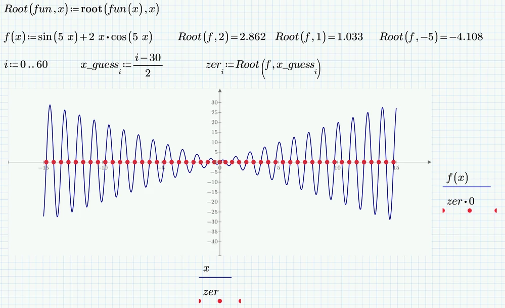

How about this approach:
Worksheet in Format P5 attached

I tried it but did not work

See my approach in the answer above
