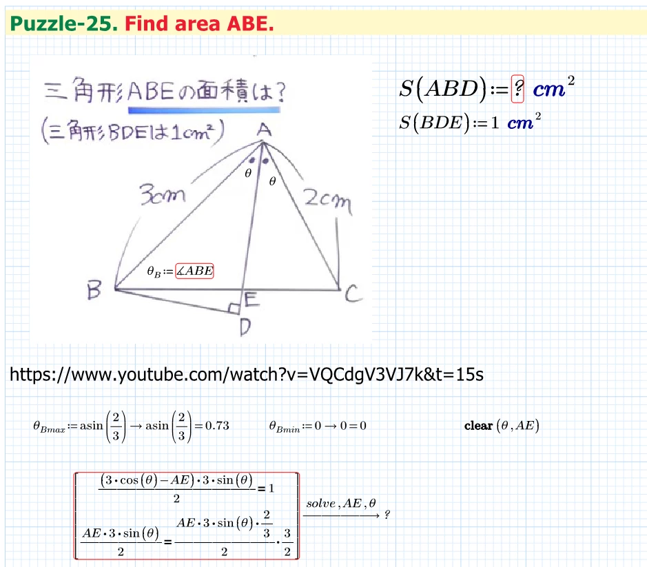

Find the area ABD.
∠BAE=∠EAC, area BDE=1. Find area ABE.
Werner_EAnswer
May 15, 2025 3:09 PM UTC

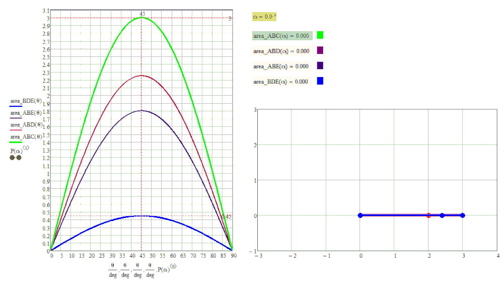

???? How could the triangle BDE have an area as much as 1 cm^2 ????
The max area possible is 0.45 cm^2 for theta=45°
BTW, you know that the youtube link you posted is a picture and so is not clickable or text-copyable!? Sure you don't expect us to retype it. 😉
And then - the area of which triangle you really are looking for? The thread topic and in the Prime screenshot we read ABD, but the thread body and the screenshot header says ABE !??

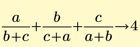

Puzzle 24 is find integer a, b and c, But it is too hard to solve.
Puzzle 25 If you find a answer, how area size of BDE, that has the largest value, and find the area ABE.
t.t.
May 15, 2025 3:24 PM UTC
Hmm, Mathcad is not made for calculations in number theory and so can't solve diophantic equations.
But using brute force it easily can find solutions like 4; -1; 11 or 9;-5;11 or a bit larger -81; -72; 40

And also all positive integers a, b and c are available.
a=154476802108746166441951315019919837485664325669565431700026634898253202035277999,
b=36875131794129999827197811565225474825492979968971970996283137471637224634055579,
c=4373612677928697257861252602371390152816537558161613618621437993378423467772036

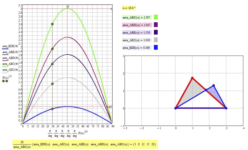

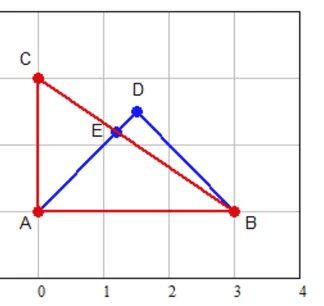

The original question is find the ratio S(BDE):S(AEC).
t.t.
May 16, 2025 11:17 PM UTC
3:8, independent from theta
BDE : AEC : ABE : ABD : ABC = 3 : 8 : 12 : 15 : 20
