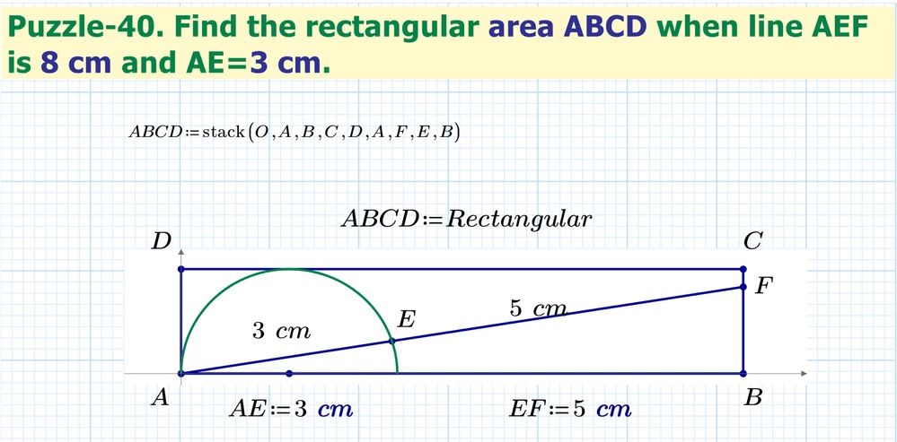

Find the area of rectangular ABCD. Green line shows half of a circle.
Green shows circle of half.

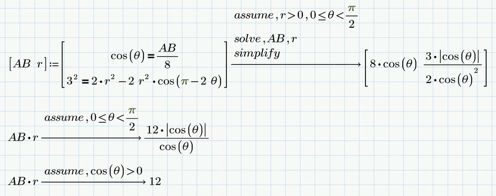

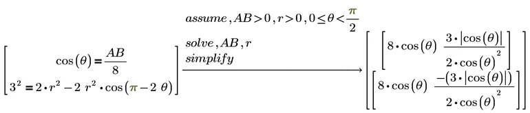

Here you are:
Unfortunately Primes symbolics does not know that the cosine of an angle from 0 to 90° is always positive.
We have explicitly tell the program that cos(theta)>0 to get the desired solution.
A strange effect occurs when we add AB>0 to the assume modifier.
The result now is a nested(!) matrix. I consider this being a bug in two respects.
Firstly, the second solution does not take into account the constraint r>0 and secondly, if there were two pairs of solutions, these would have to be output in the form of a 2x2 matrix and not in this nested form.

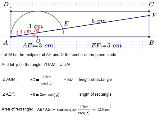

Another handwork result.

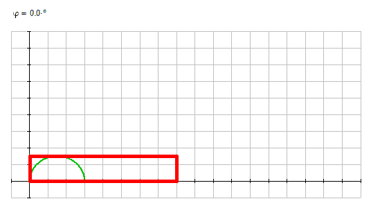

My approach is similar to Luc's
There is no use for Mathcad's solve capabilities...

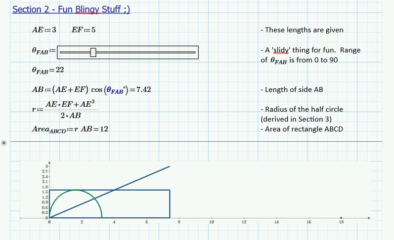

Here is mine.  I also included a plot where the user can vary the angle with a slider.  The proof comes later in the sheet.

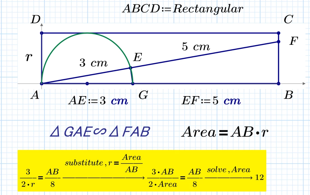

Thanks all. This is also 12 year's kids puzzle. So without using cos(θ) it is also solved as below.
