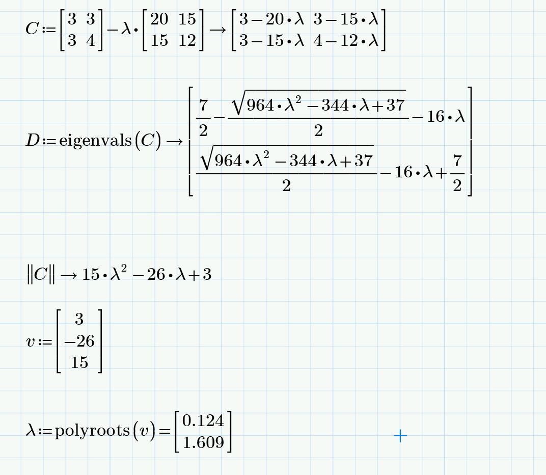

Is there a way to find the value of lambda using the eigenvals function in Mathcad?
What have I done wrong such that it cannot return to the numerical solution such as the polyroots results?
For this simple question, the polyroots function is acceptable,
but I assume using the eigenvals be more convenience when there are much bigger matrix that needs programming.
BTW, is there any recommendations for the method to use, when say there is a N Degree of Freedom vibration system, that N is the input of a function, that returns to the eigenvalues and eigenvectors. Is the built in Eigenvals function convenient to use?
Thank you!
Shawn

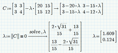

Yo are not telling us, which equation you want to be solved for lambda?
It seems that you are searching for values of lambda which make the determinant of C to zero.
So the most direct way would be

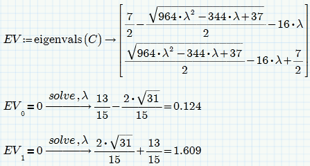

Yes, see below. If the determinant of C is zero, one of the eigenvalues has to be zero. But I see no reason why you would use this method.

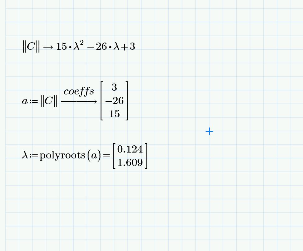

If you really want to use "polyroots", you could do it a bit more convenient that way:

I just figure out that maybe this way is more efficient.
