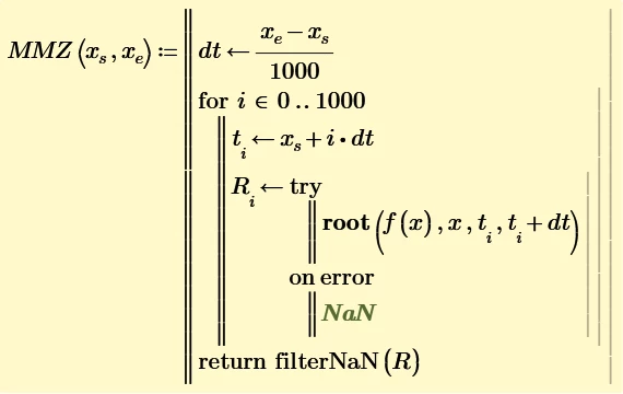

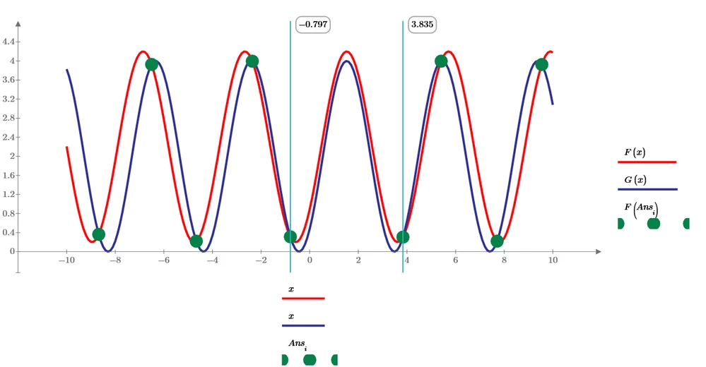

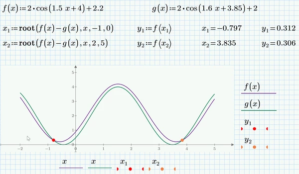

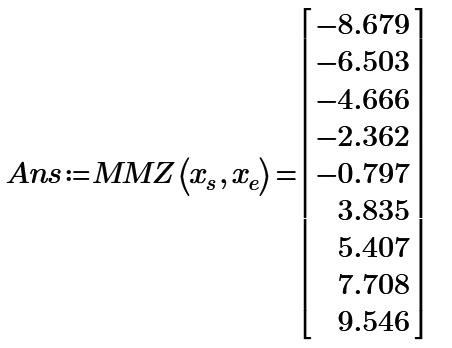

Werner_EAnswer
May 21, 2023 9:52 PM UTC
Here is one way, using the numeric "root" function
File format: Prime 9
Werner_E25-Diamond IAnswer
