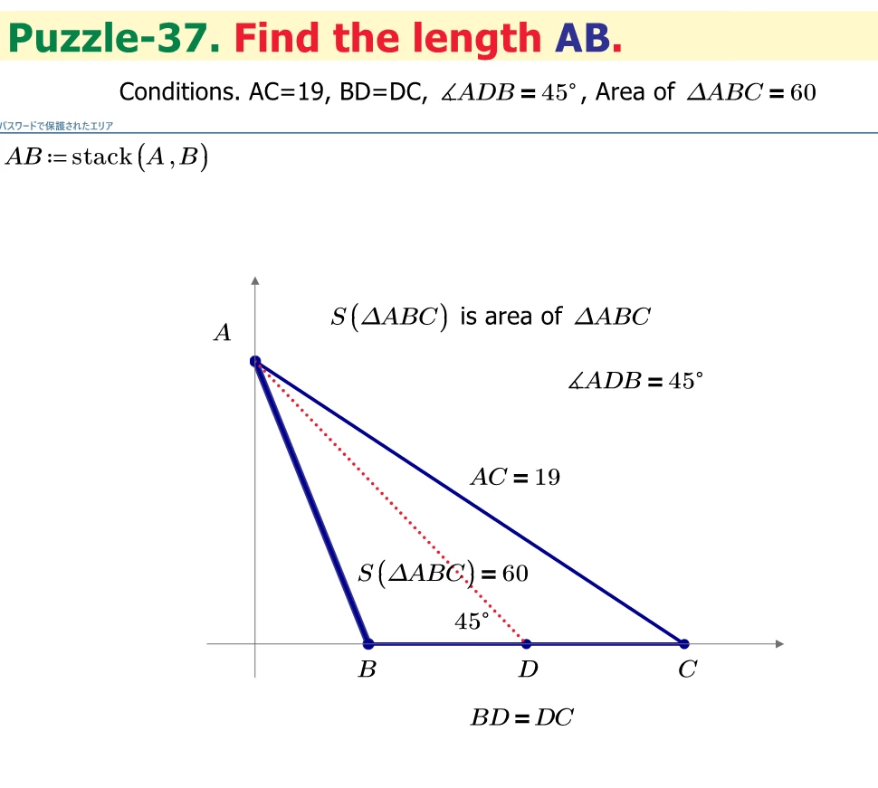

There are two intermediate solutions. In the end AB=11 in any case 😉

If we use Mathcad it is easy to find the answer. But without sqrt or functions, this puzzle becomes very hard.
t.t.
Mar 24, 2024 5:58 AM UTC
This task is not particularly difficult. Students should be able to solve it using the cosine law for side length and the sine formula for the area of a triangle. What is much more interesting about this problem is that solution "11" is possible in two different geometric situations.

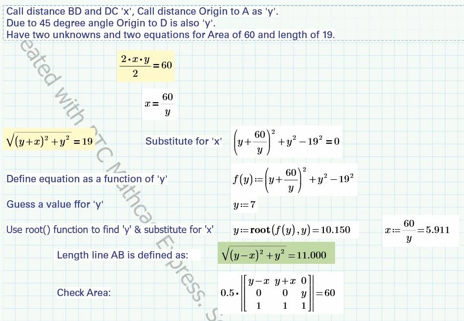

terryhendicott
Mar 24, 2024 8:01 AM UTC

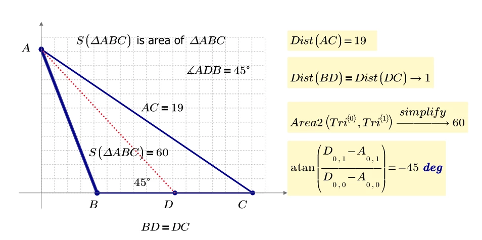

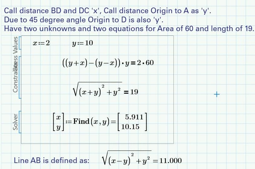

Prime 9 Express version:
Cheers
Terry

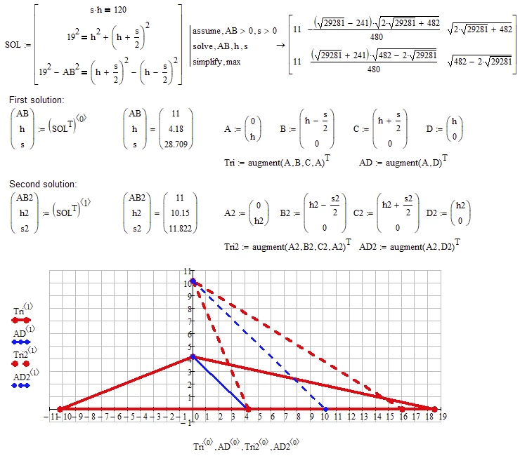

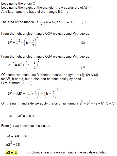

Apr 5, 2024 12:32 AM UTC
I would solve it that way:
Using Mathcads solving and plotting facilities it may look like this:
Mathcad 15 sheet attached
