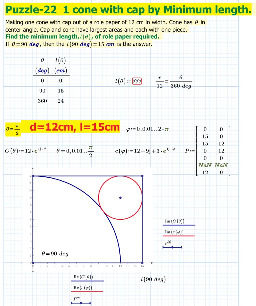

Find the minimum length, l, of role paper required.
Making one cone with cap out of a role paper of 12 cm in width. Cone has θ in center angle. Cap and cone have largest areas and each with one piece.
Find the minimum length, l(θ), of role paper required.
If θ=90deg, then l=15 cm is the answer.

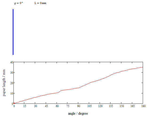

I understand what you do. I just think its inconsistent to forbid making the cone larger than 12 cm side length (like in Lucs 45° solution) but accept to make it smaller for angles larger than 180°. Just my 2 cent.
I would rather stay with "largest surface but minimal paper" throughout or with constant side length 12 cm and minimal paper (which would allow only angles from 0 to pi.
Here a numerically derived solution for the latter:

September 29, 2022
Thanks, challenge this puzzle.  θ=90 degree is the Entrance Exam of High school in Japan. It requires the position of cap and the length of role paper with minimum length.  My answer of the one of 45 degree is here. l=12/sqrt(2).
t.t.

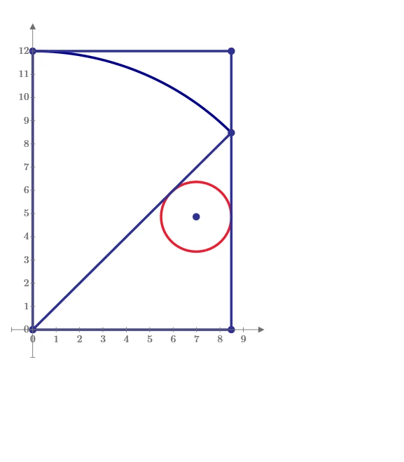

September 29, 2022
Hmm,
Note that the cone height is not specified.
When cone and cap  have 'largest areas' (possible, given the width of the paper roll)
I get this for theta=45 deg:
And here the paper length required is 12 *sqrt(2).
The smaller theta, the longer the paper required...
But also, the higher the cone.
