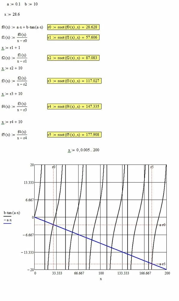

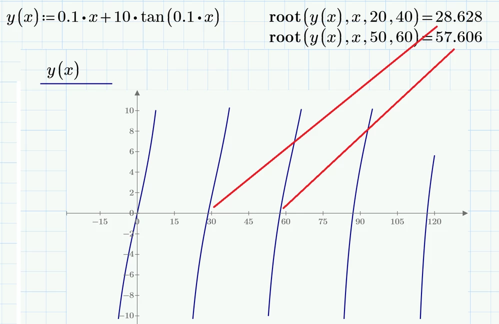

I want to find first five roots of this equation using mathcad . I could'nt able to find any helpful info on the web, so i am posting it here
0.1*x+10*tan(0.1*x)=0

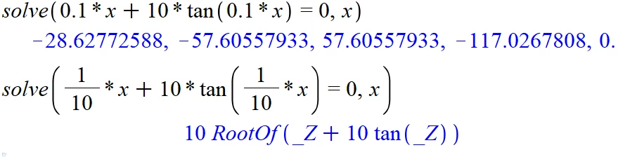

Sep 28, 2017 4:26 AM UTC
Maple
-MFra-
Sep 28, 2017 8:05 AM UTC
dilraj1-VisitorAuthor
Sep 28, 2017 5:54 PM UTC
Thank you so much for your time and great method @-MFra-, but how do we guess x=28.6  initially. Like here u input initial value of x directly
-MFra-
Sep 28, 2017 6:46 PM UTC
honestly, I took that value empirically, looking at the chart, which seems to me the quickest method. However, if you want to calculate it automatically, you might try applying the method used to initialize a root, that is, the method of the "Gershgorin" circle in the complex plane. If you are interested there are also complex roots, I believe.
