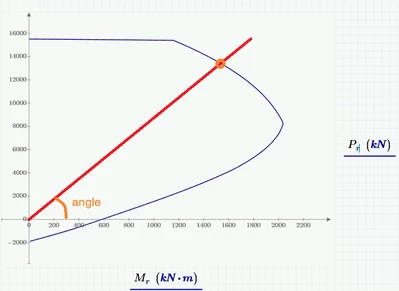

Find the values matching the boundary defined by vectors
I have the following boundary and an angle with the origin
Pr and Mr are 1 x n vectors. I need to find, by interpolation, what is the value of Pr and Mr that correspond to the angle. what is the easiest way to do that on Mathcad?
I am using Mathcad prime 9.0.0.0. Attached the file

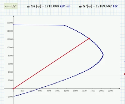

One way I can think of is to calculate a vector Phi with all angles corresponding to all points (M;P).
Then you can create two interpolating functions (may linear interpolation with "linterp") M(phi) and P(phi) using the vectors Phi and M , and Phi and P respective. Now you would have functions which return M and P values for any given angle phi.

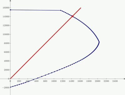

OK, when you talk about the angle you have to be aware that this angle is dependent on the units the quantities are displayed in.
Should a point like #10  M=1423.44 kNm,  P=14074.94 kN  correspond to the angle 84.225 °  ??
It won't look that way in the plot because different scales are used on both axis:
