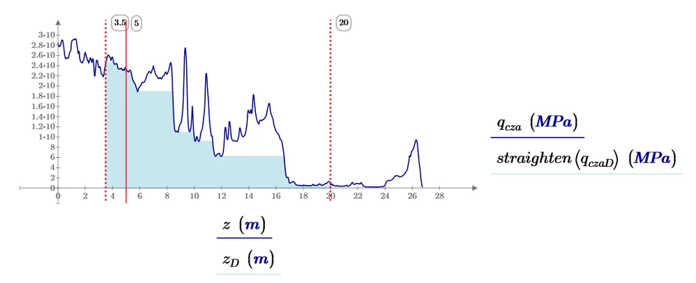

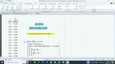

need to find q1 which is basically the values of qcza( known variable) qcza is the resistance in known depth [z].
q1 is equal to qcza when the depth is between 0.7D<z< 4D when D=0.4 and it has always to choose the minimum value until there is smaller value. the file is attached

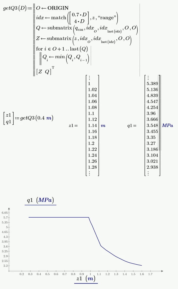

So lets see if this next try comes closer to what you have in mind ...
Prime 9 file attached

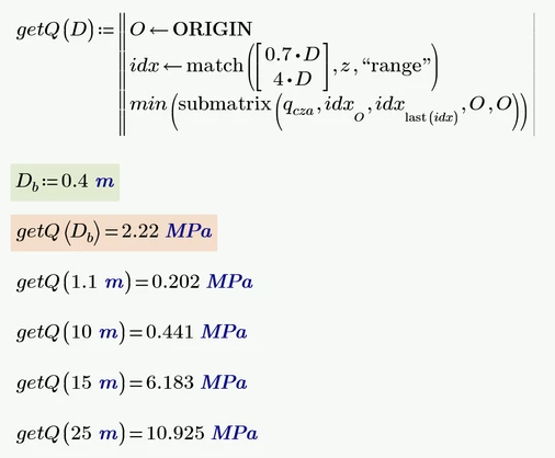

Its not perfectly clear to me what you are looking for.
As I understood:
1) Input value is a length D (in your example 0.4 m)
2) a range is calculated running from 0.7*D up to 4*D (in your example 0.28 m up to 1,6 m)
3) We look up all the q-values corrsponding to the range calculated in #2 and select the smallest of them
In your example the output would be 2.22 MPa (which by chance happens to be at the upper end of the interval. Is this correct?
Or should we chose the q-value corresponding to the smallest z-value (-> 5.721 MPa, first value in interval)?
OR ...?
BTW, your data looks a bit ... erratic, doesn't it?
Here is how I would implement the algorithm described above - as a function with D as input and the q-value as output.

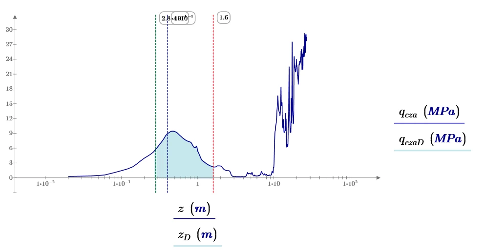

The input values are z and qcza
Where z is the depth and qcza is the resistance in each z depth … for example at depth z= 0.2 m the resistance is qcza=3.995 MPa
d = 0.38 m ..0.7d=0.2 m and 4d = 1.4 m
Now q1 is equal to qcza when z is between (0.2<z<1.4)
I need to write a program showing the values of q1 as a range
Considering that q1 should be always small when going deeper .
For example if qcza is equal to = 7 /8 /6/7/9
The program should choose q1 as q1= 7/ 7/6/ 6
Always goes with the smaller number
I hope you get it
