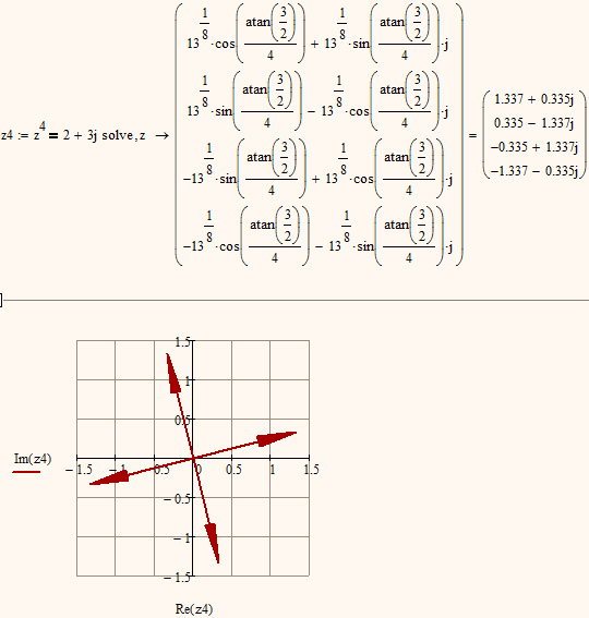

Jun 13, 2014 6:53 PM UTC
Use the symbolic processor and the rectangular keyword to rewrite the expression in the form a+bi
To find the roots convert that to the polar form, and use De Moivre's theorum.
Jun 13, 2014 9:13 PM UTC
To get Mathcad to automatically give you all 4 roots you have to symbolically solve the equation z^4=2+3i
sparrow911-VisitorAuthor
Jun 13, 2014 9:26 PM UTC
Thank you very much Werner.
