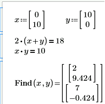

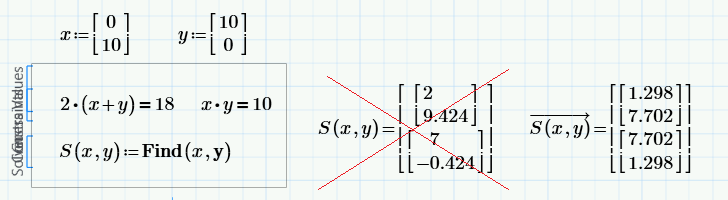

For correct solution:
1 .Guess values vectors should be placed before the solve block (why?)
2. The solution should be vectorized.
Viktor

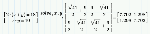

One simple solution:
Sorry, Valery. Your solution is incorrect. Check please.
Viktor
May 26, 2015 7:04 AM UTC
Sorry, it is an error of Mathcad 15 and Prime too
I remember in Mathcad 11 all was OK with guess values as Viktor, pardon, vector!
