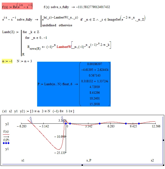

Finding another solution from the symbolics' hint ?
Hello Evryone.
From :
1.PNGFinding another solution from the symbolics' hint ?
Thanks in advance.
Werner_EAnswer
If you mean understanding the math behind, labert W -function, complex analysis, etc. I think its better to rely on one or more of the many books about this subject rather than watching mathcad struggle with the tasks.
If you mean understanding how to work with Mathcad's symbolics, then you already have learned that Mathcad and especially its symbolics is rather weak when it come to more complex (pun intended) problems and it ever so often fails to provide a solution, provides only part of the solution and in some rare cases even provides a wrong solution.

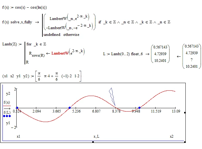

Now I have the relative and similar question :
How to make a correction to my guessing-program-function for finding two more solutions in this range ?
Best Regards.
23-Emerald I
As help, the internet, and Werner have shown, the Lambert W function has two branches.  What does Lamb(0,4) give you for zeros?
lvl10720-TurquoiseAuthor
20-Turquoise
Please help and make a correction.
