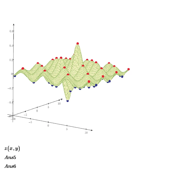

I have 2D arrays with multiple peaks in the array.  I need to extract the centroids of each peak.  I have MCAD14 with all the extensions but am not seeing any function that will help with that, but trying to avoid writing the whole matrix search algorithm myself.
I'd like the array positions of the centroids of the peaks shown in this plot as the red peaks.
Any ideas that make this simple?
Thanks.
ttokoro
May 23, 2024 2:38 AM UTC

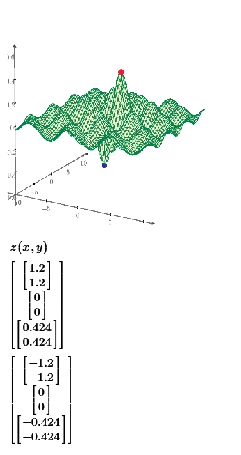

Even Prime can do it by localmax function, real mathcad can do it.
t.t.
May 25, 2024 12:38 AM UTC

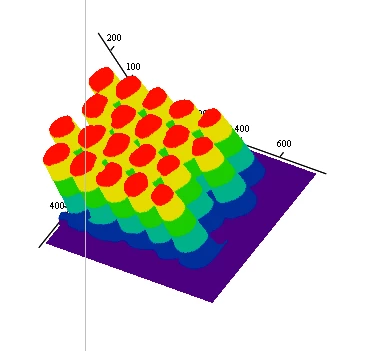

That's a very good recommendation.  Unfortunately my data has a large maximum uniform value 'table' so localmax doesn't seem to be able to deal with that.  I could back off the gain on my data so the peaks are not saturated values, but then the shape of my data is more like the cone of a volcano with a central depression.  I may just have to write an algorithm myself for this.
