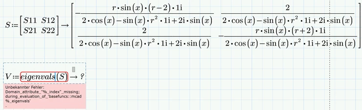

I want to obtain eigenvalues symbolic equation for the matrix. Any help would be greatly appreciated.
Attached file.

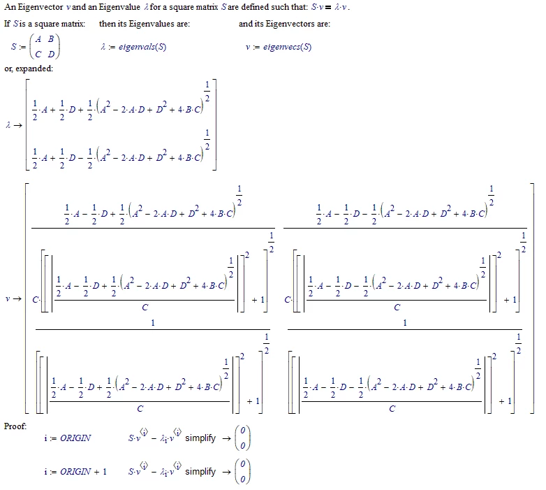

Maybe this helps:
May 29, 2019
You missed the "s" in "eigenvals" and so "eigenval" is treated by the symbolics as an unknown/undefined function.
Unfortunately Prime seems not to be able to calculate the eigenvals of your matrix - I get an "unknown error".
Durani1-VisitorAuthor
May 29, 2019
I am getting same error...

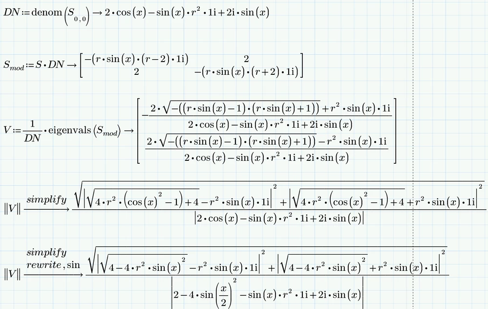

Sure 😉
But as the denominator of the elements in your matrix S is the same, you may help yourself by getting rid of it for the calculation of the eigenvalues and add it manually:
