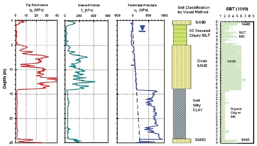

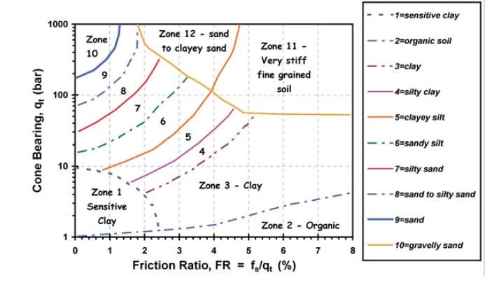

Hi all,
It is nice to see that this problem has generated discussion.
The situation for which I need this inside/outside -test, was illustrated in the last section of the attachment in my original question (, but not very clearly, my apologizes for that...)
In principle, from a CPT (Cone penetration test) which is used for soil investigations, we get a large number of
sleeve resistance values fs and tip resistance values qt. Typical CPT test result is shown in attachment.
With these two values, the soil type can be defined using the charts presented in the second attached picture.
The main issue is to find, that in which area each fs/qt - qt -point hit.
My intention was that after this issue with one polygon is solved, I'll make a program that checks all the areas and defines in which area each point has hit. From those evaluations soil layers could be defined for all depths.
