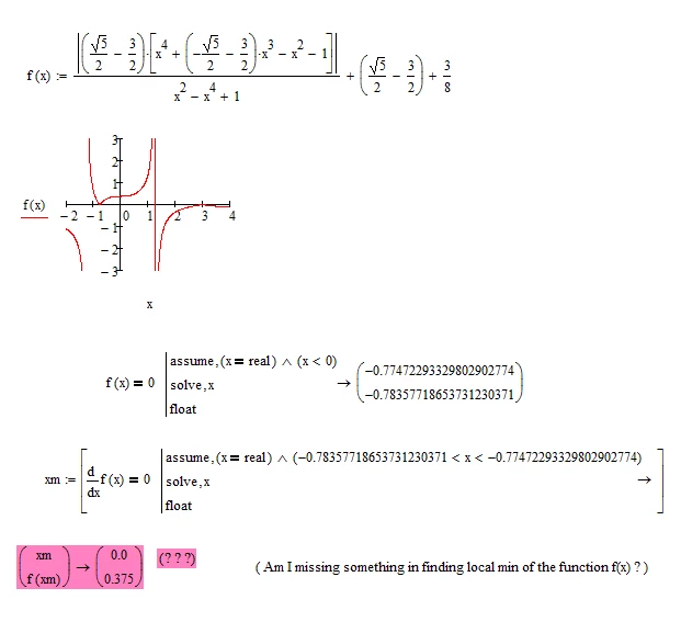

  Hello Everyone.
  From :
  Am I missing something in finding the local min of the function f(x), the above ?
  Thanks in advance.

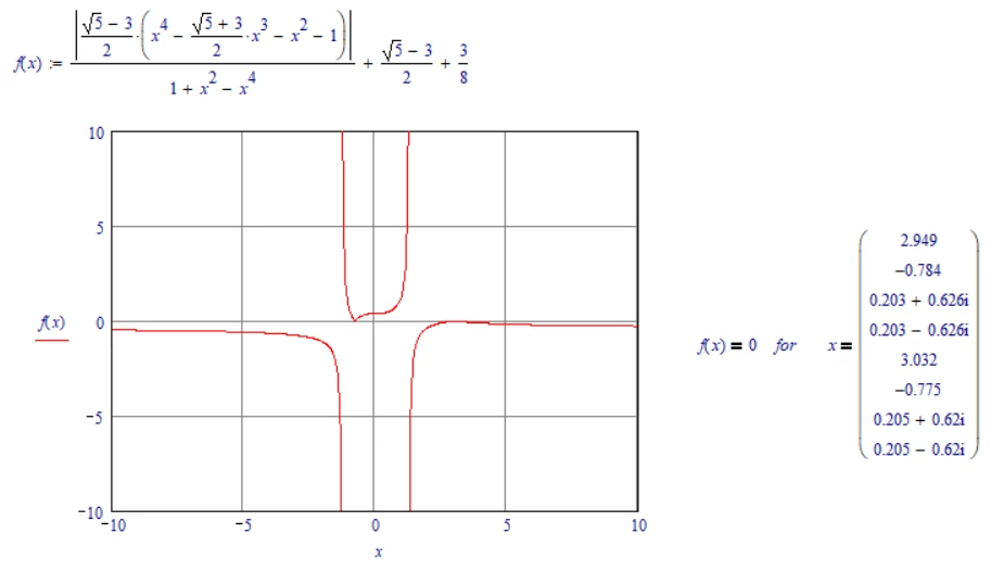

I'll spare you a picture of the symbolic solution (4 pages high, 16 pages wide), but this is what Mathcad 11 (with Maple) makes of it:

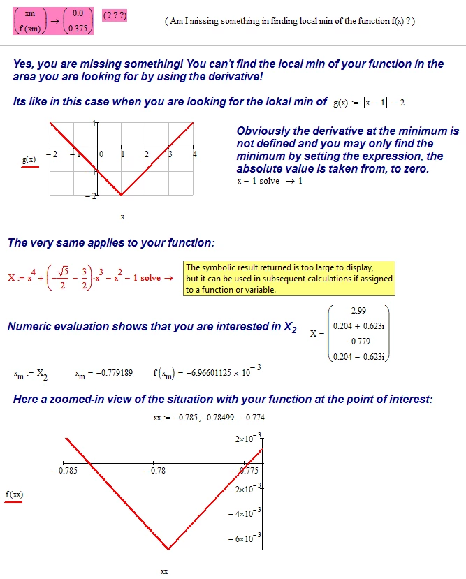

Werner_E25-Diamond IAnswer
Oct 11, 2018 7:34 PM UTC
