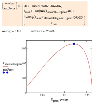

Hallo guys,
i have a question regarding finding a maximum value out of a matrix.
I have an overlap , maximum transmissible force, NOKOK Matrix
i now need to find the overlap for the maximum transmissible force under the condition "OK"
The values in the matrix are only valid for "OK"
For the given example the correct overlap is 0,127 mm with 649,736 kN
Can anyone help me out how to determine this problem?
I have Mathcad 15
Thank you Br Stefan

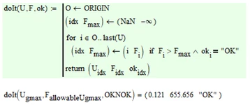

And here is a more classic, straightforward approach using a loop. Again w/o using an augmented matrix.
It works without using match,trim, max and lookup.
It's your choice now.

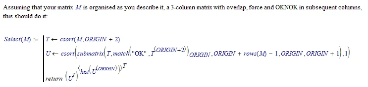

July 31, 2019
Use the csort () function twice. First on the NOKOK column, then on the force column.

July 31, 2019
Is it this what you are looking for:
