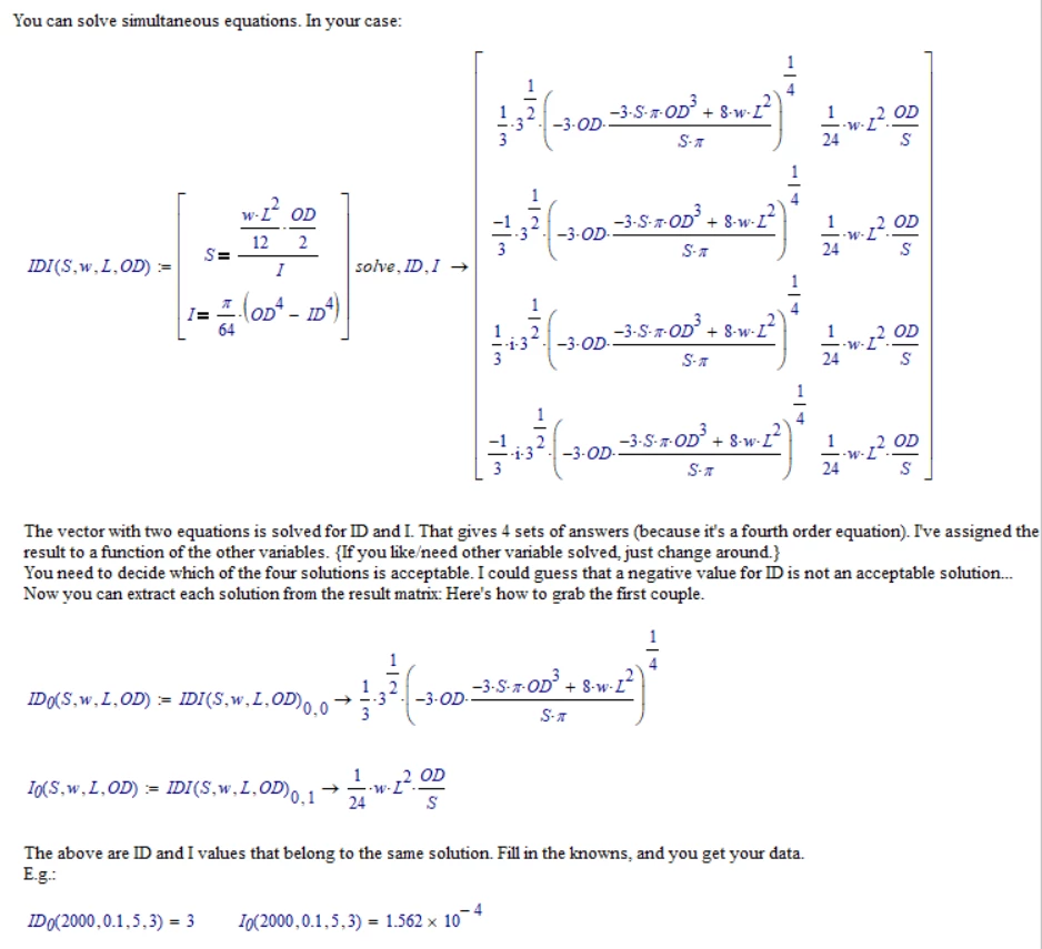

Like this:
Note that I is the same value, for each of the four solutions, the second solution gives a negative ID and the last two of the solutions for ID are pure complex (imaginary) numbers.

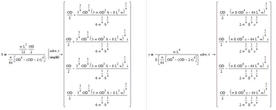

As Terry indicates you may not be able to satisfy both equalities at the same time.  I rewrote your equations for y and S putting in t (ID = (OD -2t).  If I divide S by y I can get:
You can solve either equation of S or y for t:
Whichever is more critical will depend on the actual problem.

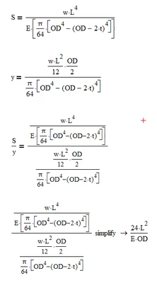

Depending on the problem one of your two limits will be more restrictive than the other.  You can derive an expression between y and S that does not involve the thickness:
The attached sheet gives a starting point.  (In my experience, designing for deflection is usually more restrictive than designing for stress.
