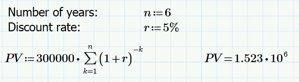

I am earning 300000 per year with a discount rate of 5%.
Formula: PV=FV*(1+r)^-n
What will me present value be after 6 years.
My problem is when im plugging numbers in, it takes a lot of times when plugging all the numbers in.
Is there any way to make some kind of shortcut??
This is how i am doing it right now.
RichardJAnswer
May 27, 2014 1:54 PM UTC
Like so

May 27, 2014 1:25 PM UTC
Send please your sheet!

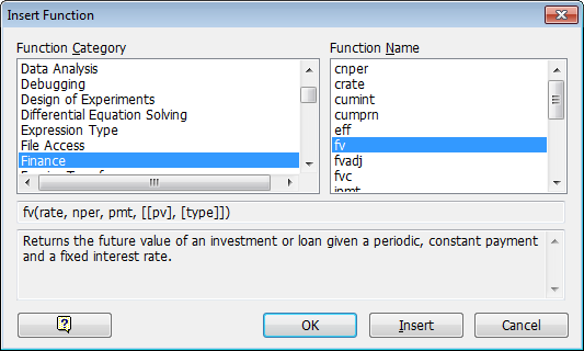

May 27, 2014 2:10 PM UTC
May 27, 2014 5:01 PM UTC
No, not fv() but pv(5%, 6, -300000)=
Rojvansu1-VisitorAuthor
May 27, 2014 9:06 PM UTC
Thanks alot Richard !!
